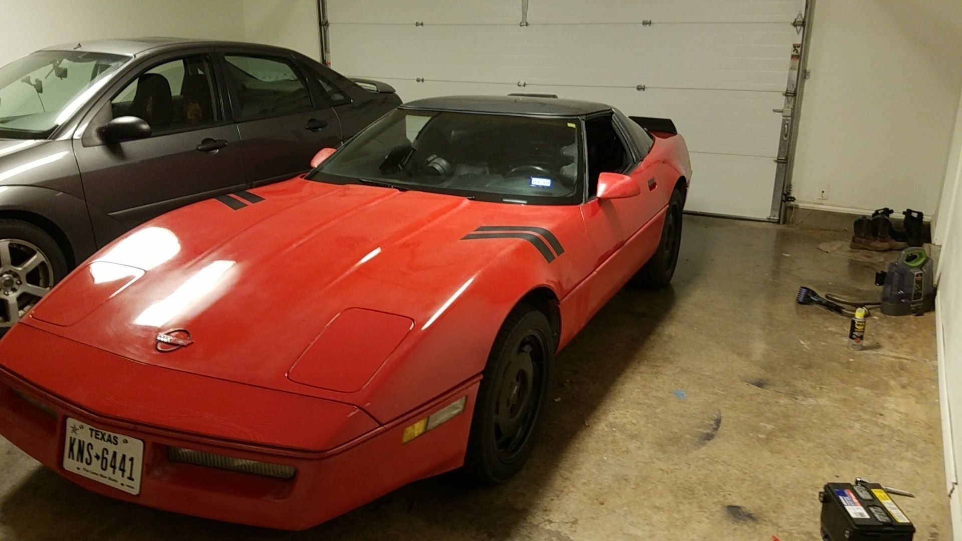

Hi guys,
so a few days ago I bought my first corvette, a 1990. Got a great deal on it in my opinion but it does need a little work on the inside. It's missing the radio, the screen right above the climate control doesn't work (I think it's the driver information screen?) The LCD part of the dash cluster does work with the Speedo and such, but none of the analog gauges work (tach, oil, temp etc). It has aftermarket gauges mounted in it right now. The A/C works but doesn't blow the hardest, I can't seem to get the heater to kick on though.
So I know that's alot there. But the rest of the car is pretty solid especially for the price. I'm hoping you guys can help me out since I have no idea where to start looking for issues with the climate control or the driver info screen. Ive worked on cars all my life but the electronics seem a little fancier than my 79 trans am i had before and the basic radio installs ive done.
The instruments seems like are a common problem going out so I'm sure I'll just have to replace the cluster. But if you guys can give me a little insight on where to start with those that'd be great. Thanks!
