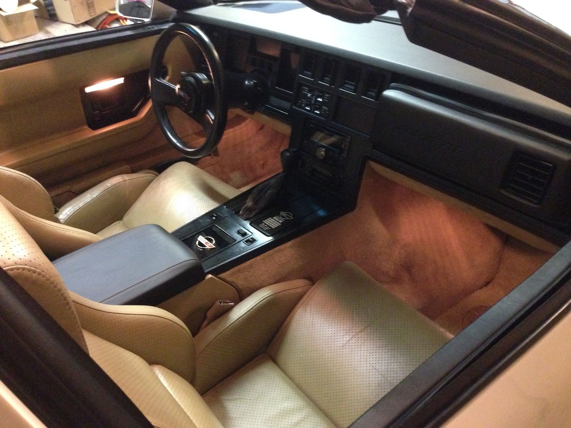

Probably tech, but it looks like more guys in gen do these types of mods.
I made some delete pieces and I have grey trim/bezel on my '90 that I want to paint black.
This is not a show car, it is nothing more than a functional, hot, loud, and "hacked" car.
My question is; how would you go about it, and would you go gloss or flat? (most is black/tan)
I thought i would scuff it,, clean it, prime it, and paint it..
Open to ideas, or any input and not offended by any opinions.
Thanks for any thoughts!

I think you are on the right track, I would just put a clear on top of the final coat for protection. Plasti dip might work if the surface is not perfect, lay down a few light coats to fill in any imperfections.

polo. if factory match is what u are after, clean with degreaser, then SEM Landau Black is your answer.
light coats.

I would recommend using a satin finish on it. Flat just looks like primer. Gloss is too much shine for the interior.
Or if you want to be different, Rustoleum has a finish called "Iron- Hammered", (I think). It has a subtle gray-black swirl look
to it, with a slightly textured finished.

Clean it with sem soap, scuff it with 400 grit sandpaper, wipe clean, spray plastic adhesion promoter, spray sem trim black.
I fabbed my center dash to accommodate the double din radio and used that process. That was 4 years ago and it still looks the same.

I just cleaned the parts with soapy water and a scotch brite, bought a multi purpose primer for ANY surface, and cheap black matte paint and matte clear. Looks better than I thought.
