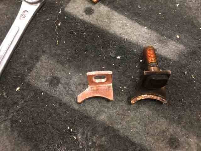

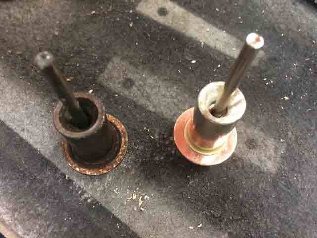

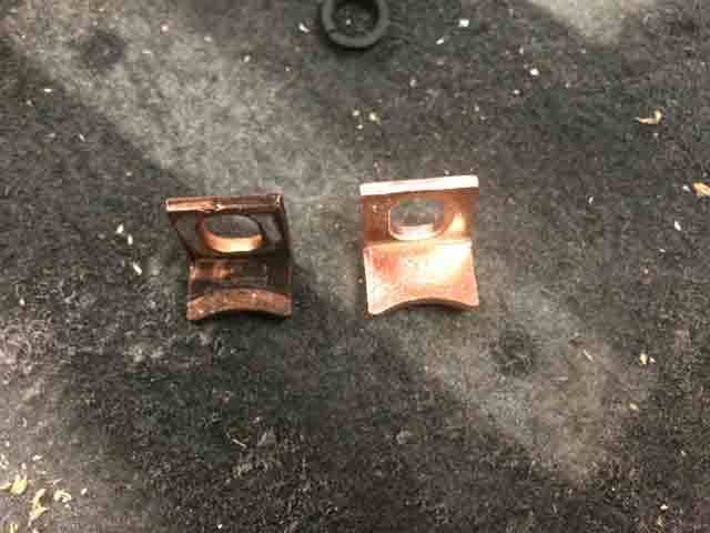

If I understand your problem, it was the same as I had on my 92. It takes 2-3 seconds for the starter to engage and spin.
It was the contacts in the starter. Simple fix costs around $20 for parts and about an hour or two to do start to finish.
Over time the contacts burn and build up carbon. When you turn the key it takes a few seconds to burn through the carbon.
here are some pics of what I found with new parts for comparison

I used this kit. As I mentioned the repair is pretty simple.
https://www.amazon.com/gp/product/B0031HMS7C/ref=oh_aui_detailpage_o09_s00?ie=UTF8&psc=1 https://www.amazon.com/gp/product/B0031HMS7C/ref=oh_aui_detailpage_o09_s00?ie=UTF8&psc=1

I went as far as adjusting the ignition switch down on the column (Which is a pain) before I found out about the starter contacts here on the forum.
