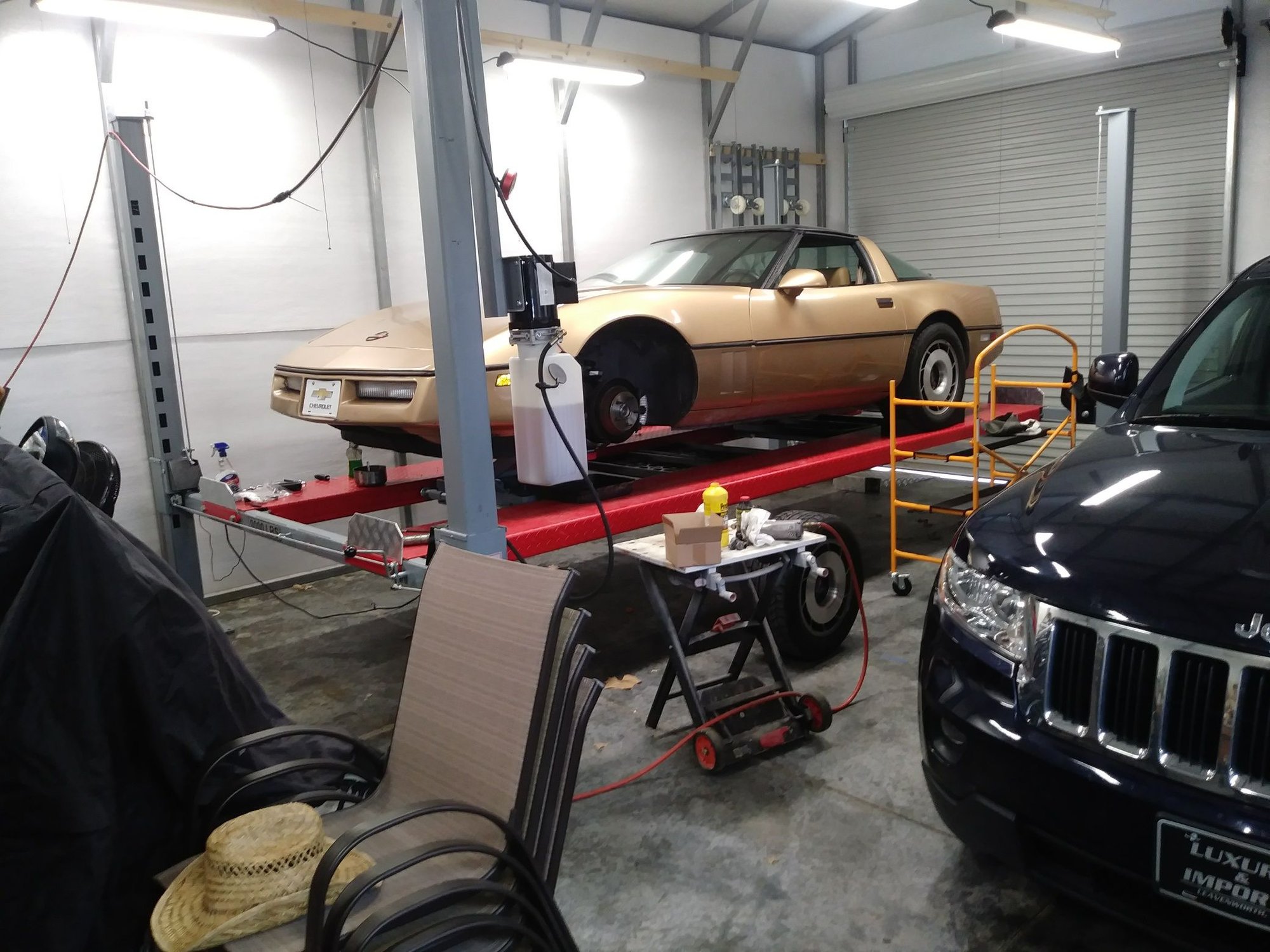

Hi guys, Back working on the Corvette. The question came up on why only change one hose. I purchased both hoses but somewhere in the middle I ended up with a torn Macular and required eye surgery on October 5th. I am just now back to where I can see enough to begin working on the car again. I installed the second hose on Sunday and working alone set up a bleeding bottle. When I first attempted to push the pedal down with my hand (car was on the lift) I couldn't budge it. With the bleeder open I climbed up in and with significant foot pressure the pedal finally went down. I couldn't see anything in the bleed bottle except dirty fluid. I continued to bleed the left side and then went back and bled the right side until the fluid was clean. I can't believe how dirty the fluid was. The car had recently had a brake job by the previous owner but no one must have flushed the fluid since new. I am cleaning the suspension and will grease things today before I put the wheels back on for test drive. Next on the hit list is the back hoses and brake fluid. I will let you know how I come out. Bob
Our Advantnage 9000 XLT lift. We love it.
You can actually tell the suspension is aluminum.
