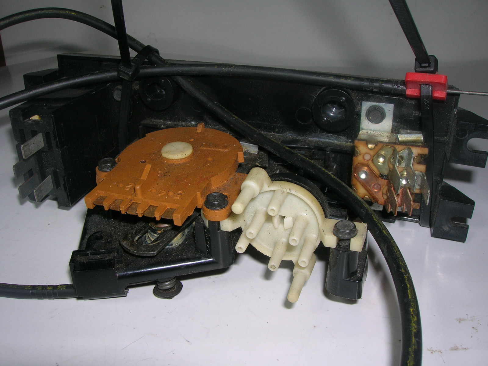

Ok I just noticed you have a leak at the controls. Is the leak coming from where the hoses connect to the lever that you move to select the mode you want. If so you need that vacuum control. It's the white one in this picture.

Yes, that's where I suspect the leak to be. How hard is it to find that part?

Might be able to do something if there is a part number. All my searching only came up with some complete units on ebay $300 to $39 just search 85 corvette climate control.

It's been many years since I needed one but you used to be able to buy those separately. Had an airman that worked for me have one fail. We picked one up at the LPS for his Pontiac.Back in the 80s they were under 10 bucks.
I think the part number was 16040637 for an 85 corvette
item 2 here 85 C60 control IPB
