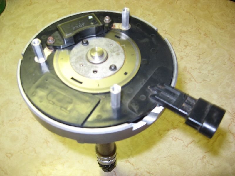

If you want a 400 CID "LT1" (if that's what you're getting at), the fastest, easiest way to that is a SBC 400, Miniram, and an "option converted" HEI distributor...then run it all off the LT1 ECM/harness.
Guessing that was supposed to be "optical converted" or "opti converted." Okay, that makes perfect sense. I see a couple writeups for making your own, and maybe the "dual-sync" aftermarket options would work? Just more time and money, but it's doable. Nothing I'm going to be worrying about any time soon, but I'll file that away in the back of my mind for the future.

Yes...OPTI Converted. God Damn spell check. It's like cars with doors that lock themselves for you. Great....until you can't get out.
That is roughly my plan for my '92; a Gen 1 SBC 400/miniram, a Tom-converted Opti/HEI. Nothing special...but it will have that nice PULL in each gear that the stock 350 doesn't.
Please tell me you're going to create a thread on that Tom-conversion!
