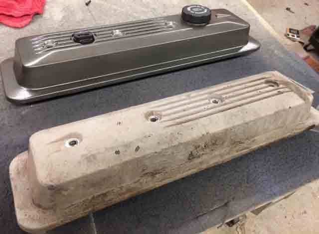

Having a 92 as well, the brown crud is the effects of age on the factory coating. They can be stripped and repainted. The magnesium looks pretty sad when bare. And since they are magnesium, you will need to do some reading on cleaning and prepping magnesium for paint. There are several threads about it here. Another option is powder coating.
Here are mine before and after painting, not back to factory, but a color I liked.

Thanks. The credit really goes to all the folks here that provided advice on prep.
I went:
degreaser
Aircraft Strip
Wash
TSP Wash
Rinse
Sweated remaining oil out
Another TSP wash
Rinse
Self etching Primer
Top coat
I've had them on for about 18 months. No issues. Now that I have a blast cabinet I'll probably redo them at some point to use a satin black. Think it would make for a more cohesive appearance.
