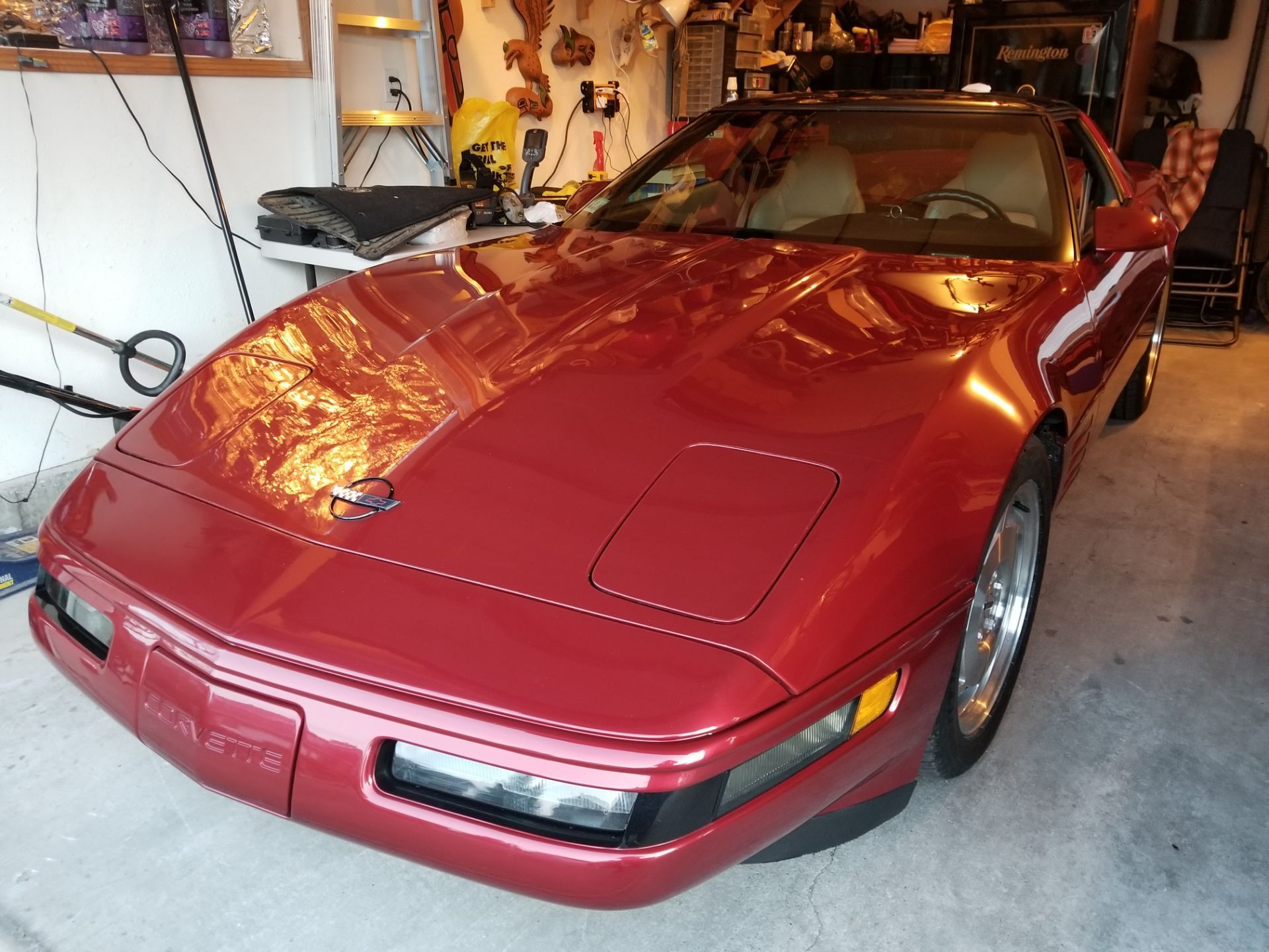

Here are a few pics of the potential toy, the Tan interior is growing on me but I would prefer Black.

Welcome to the C4 world. Everything looks to be nice and clean. That is a nice color combo! When you go to test the car, take your time and make sure that all the lights work properly and that all of the controls and buttons work as they should. Driving in the rain will not hurt the opti system. Pressure washing the engine may well indeed hurt electrical components so don't pressure wash. If you intend to keep the car and drive it, the 2-volume Factory Service Manual will probably come in handy.

While it all looks nice, it may not be on the inside. I would first off inform the seller you are getting a PROFESSIONAL mechanic to give it a Pre Delivery Inspection which will include scanning for all the codes and a compression test. If he balks, run like hell. "But I know cars. Why should I pay for it?". Well. see below.
1, You won't be sucked into buying something AND GLOSSING OVER PROBLEMS just because he infected you with the "Corvette Fever".
2. You won't be blamed for any breakage since the shop has insurance.
3. The guy will be neutral and have the tools and engine bay

Looks like a nice car. With that few miles, the opti is probably fine. It wouldnt be a bad idea to replace the waterpump and gaskets as preventative, a water pump failure is the #1 cause of opti issues. The opti job isnt that bad... the heater core is, and I've done both.
