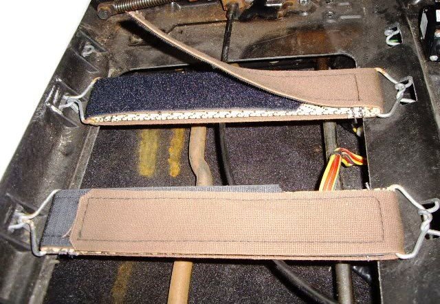

Another option: Have an upholstery shop sew up some new under-cushion straps, with velcro being used to connect the two ends. That way you can actually adjust the tension on the straps, thereby firming (less sag) or softening (more sag).
Edit: Found some pics of mine......
