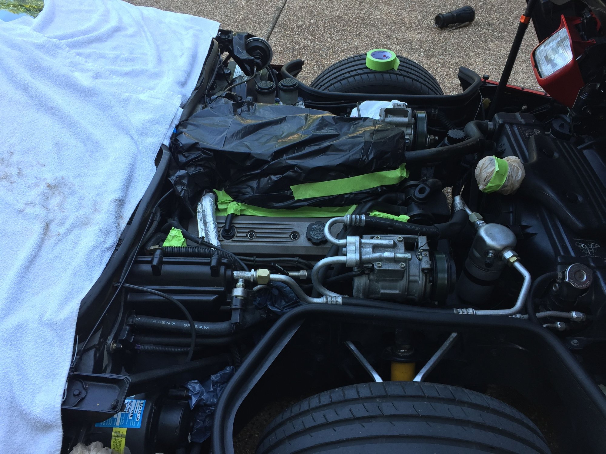

This is from a 1989 L98, but you get the point.... Tape up what needs to be taped and then just get after it.
Nothing on an L98 heeds to be taped. Get the power washer out and blast the bejeezus out of it. Fast, effective, easy.
