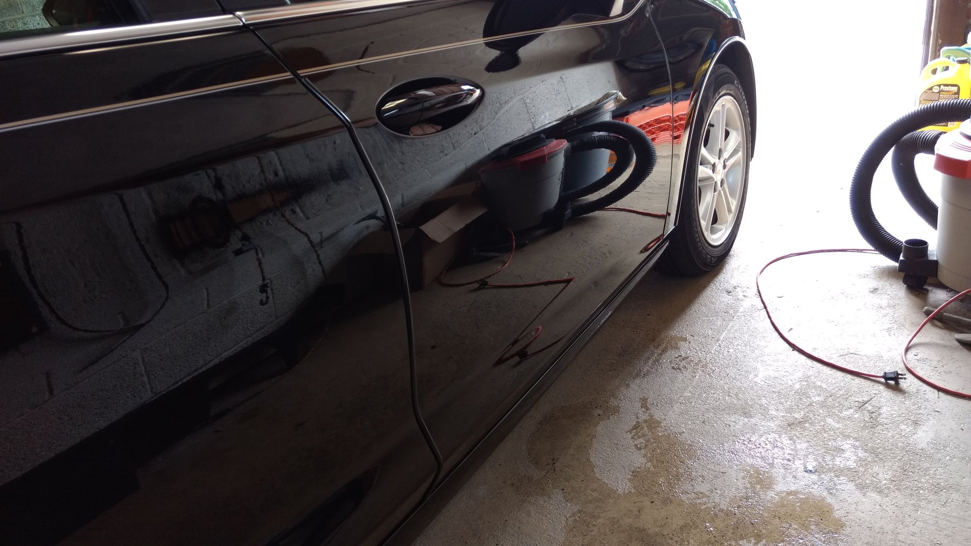

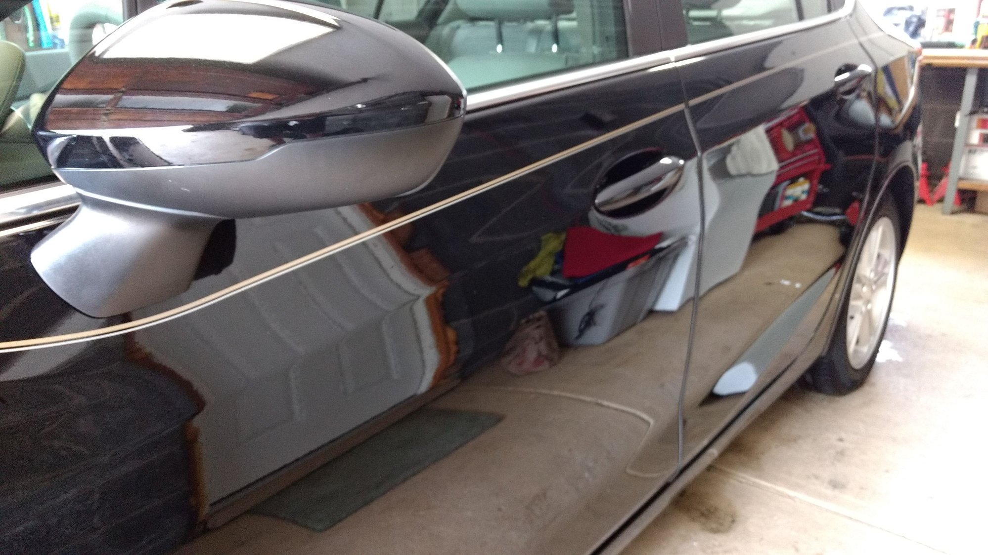

To Clay bar
Old Jun 24, 2019 | 06:28 PM
BLKMAMBA's Avatar
BLKMAMBA
Joined: Jan 2017
Posts: 702
Likes: 55
From: West Deptford New Jersey
Old Jun 24, 2019 | 07:03 PM
Hawkeye56's Avatar
Hawkeye56
Joined: Mar 2019
Posts: 843
Likes: 149
From: Iowa
Looks very good, Any more pictures of the rest of the car?
Thanks
