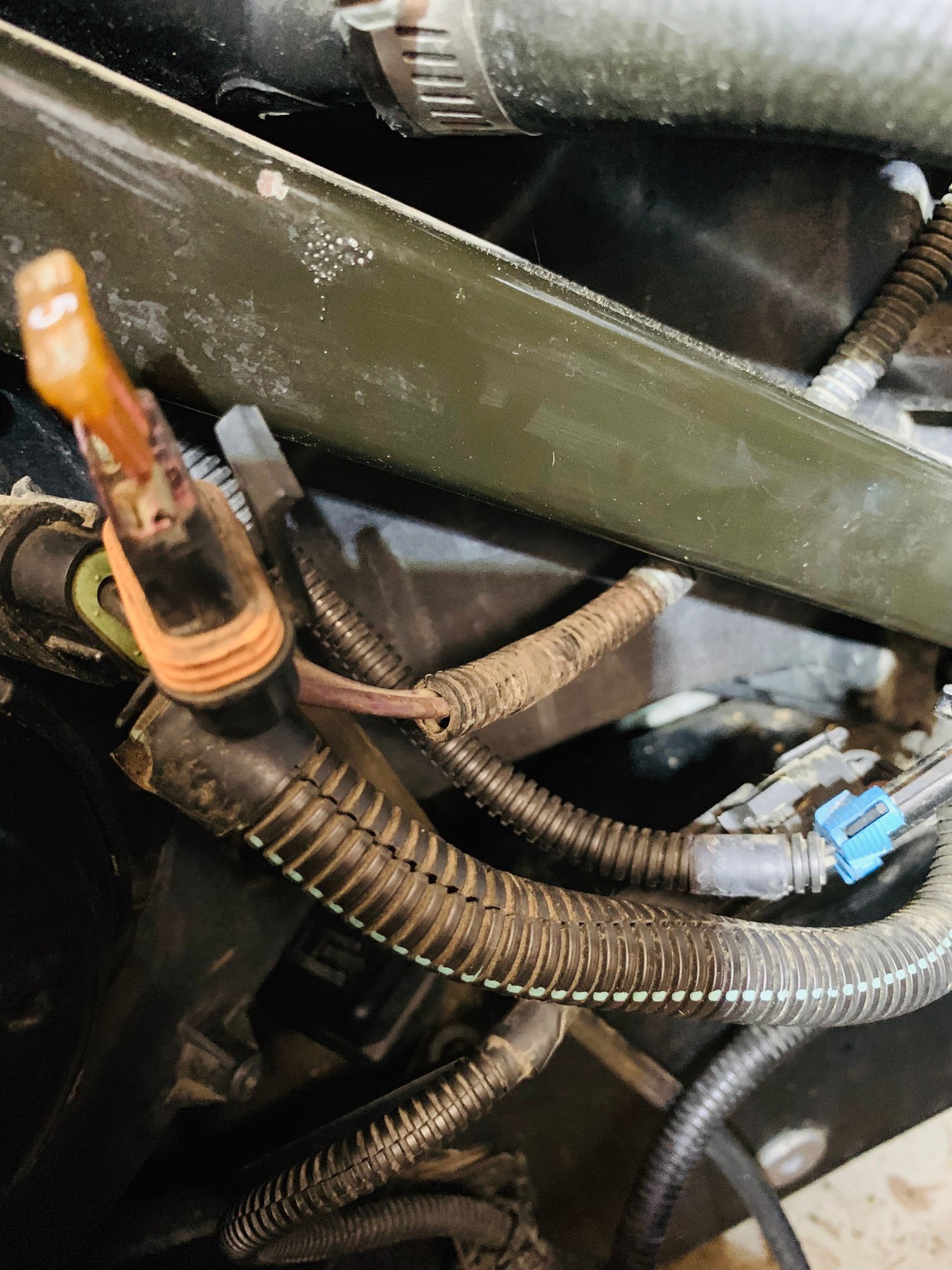

I was working on my airbag sensor because if inf light being on.
Thanks, everyone that has posted about it. I got it done.
While doing it I found a empty plastic box that say Red fuse #14.
I will attach pictures of the Jerry rig.
Where can I find that fuse?
Thanks

The uncovered fuse is what plugs into it. It is meant to protect from corrosion, which you can see it has.

The cover say red #14 fuse
The one that is half assed stuck in is a 5 amp.

It should be a 10.

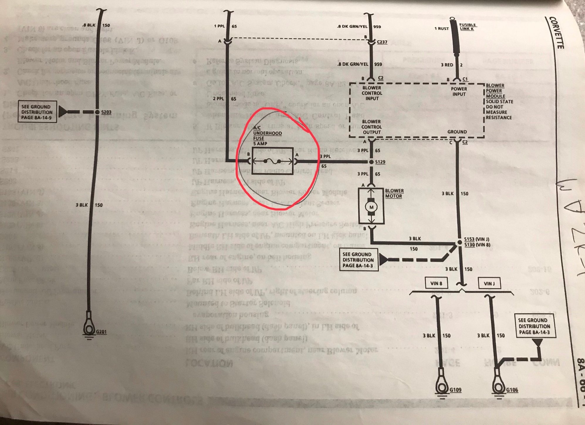

I have check the service manual wiring diagrams and still can't find what it goes to.

Originally Posted by RWR
And don't tell me what amp fuse it is if You don't know what it is for.
Judging from your snapshot 5AMP is correct and it's BLOWER FOR C68. FSM see 8A-201-4
*****If that didn't work for you see 8A-66-1 & 8A66-2 !!

Looks to me like under hood lights.

Well? Have you sorted it yet? Are the wires maybe both PPL (PURPLE)?

Thanks a lot WVZK-1
I had forgotten about the 8a sections. It was under the bed.
Yes, they are both purple.
