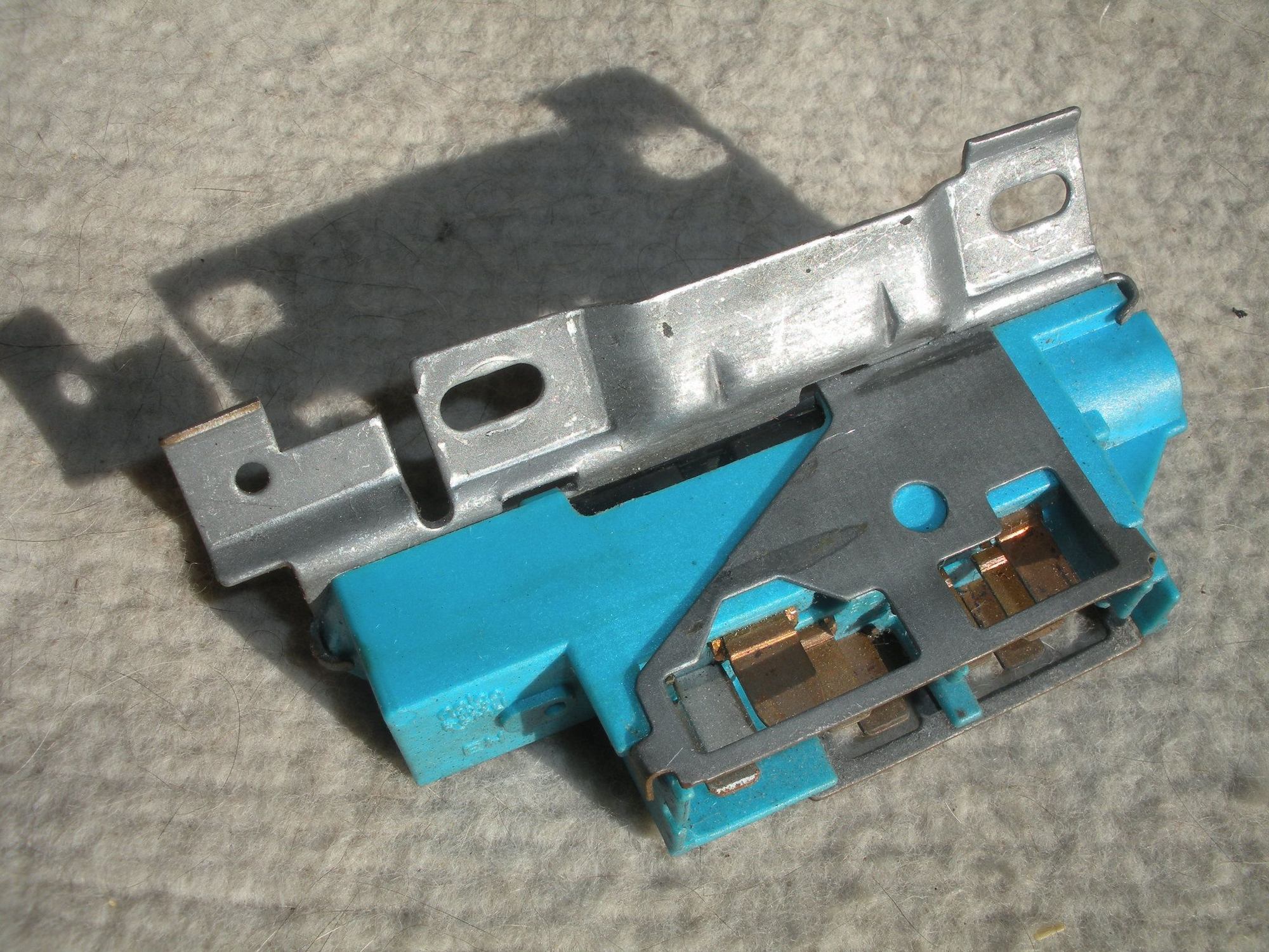

So the starter is good. It's doing something weird. The only time is will start if I tilt the wheel down a little bit to the closest setting. It sounds like something behind the steering wheel.

Is your steering wheel loose? A common problem that should be repaired, but the problem with your starter can probably be fixed by adjusting the position of your ignition switch, which is located near the bottom of your steering column. As you may know, there is a rod that connects your key cylinder to the actual ignition switch. Notice the adjusting slots in the housing:

Thank you! I appreciate your wisdom. I will get underneath there and take a look. I remember replacing this part, putting the rod in, then taking out the pin. Is there a way to adjust the rod to a different slot?

I'd try adjusting the position of the switch a little bit. The rod only fits in one position.
(The switch might be defective)

Adjusting the position would that include taking the screws out etc and the rod?

Tonight I put in a different ignition switch. This one did not have a pin in it. I put the switch in and the car started by itself without the key in it when I put the positive and negative cable back on. It was like the switch was already in the on position. The negative terminal was smoking and sparks were flying? Did I install it wrong?
did you install an ignition switch or a ignition lock cylinder?
