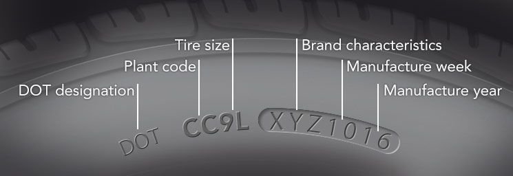

I suspect bad rear tires, they may look fine thread wise but might be hard as a rock so they would break loose coming around corners or make you feel like you have a ton of power since you're able to break 'em free at will so to speak. Some of these rarely driven or lower mileage cars that I've seen seem to have had the tires go bad, not due to low thread wear but due to old age/dry rot. When I bought my 94 back in 2017 it had somewhere around 44k miles, the Goodyear tires looked great (thread) but I had to quickly replace them as they were dry-rotting/hard from sitting and aging as someone's garage queen.
Post a picture of the tires up close and we can get the week/year the tires were produced OR here is how to check the code:
