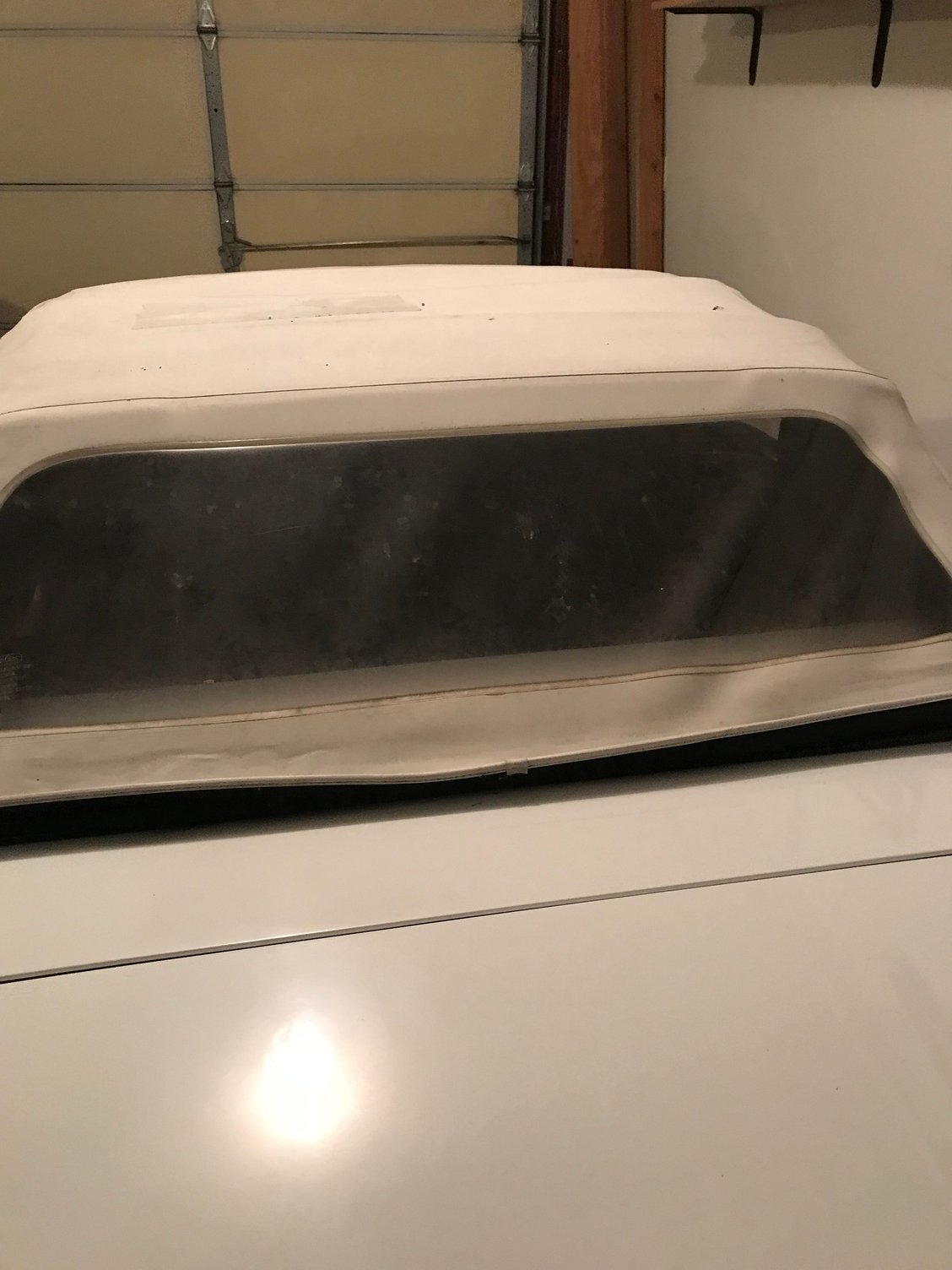

4: Transmission: no issue but I went to get a fluid and filter change at the dealership and they refused to do it. They said they did not want it to lock up. I looked at the fluid na it seems like it is newer fluid. Any comment sor suggestions on this would be grateful. Seems tha the transmission may lock if if the old fluids has not been changed???
5: Replace factory white vinyl top with black cloth top by upholster shop. $1500.00 sound right?

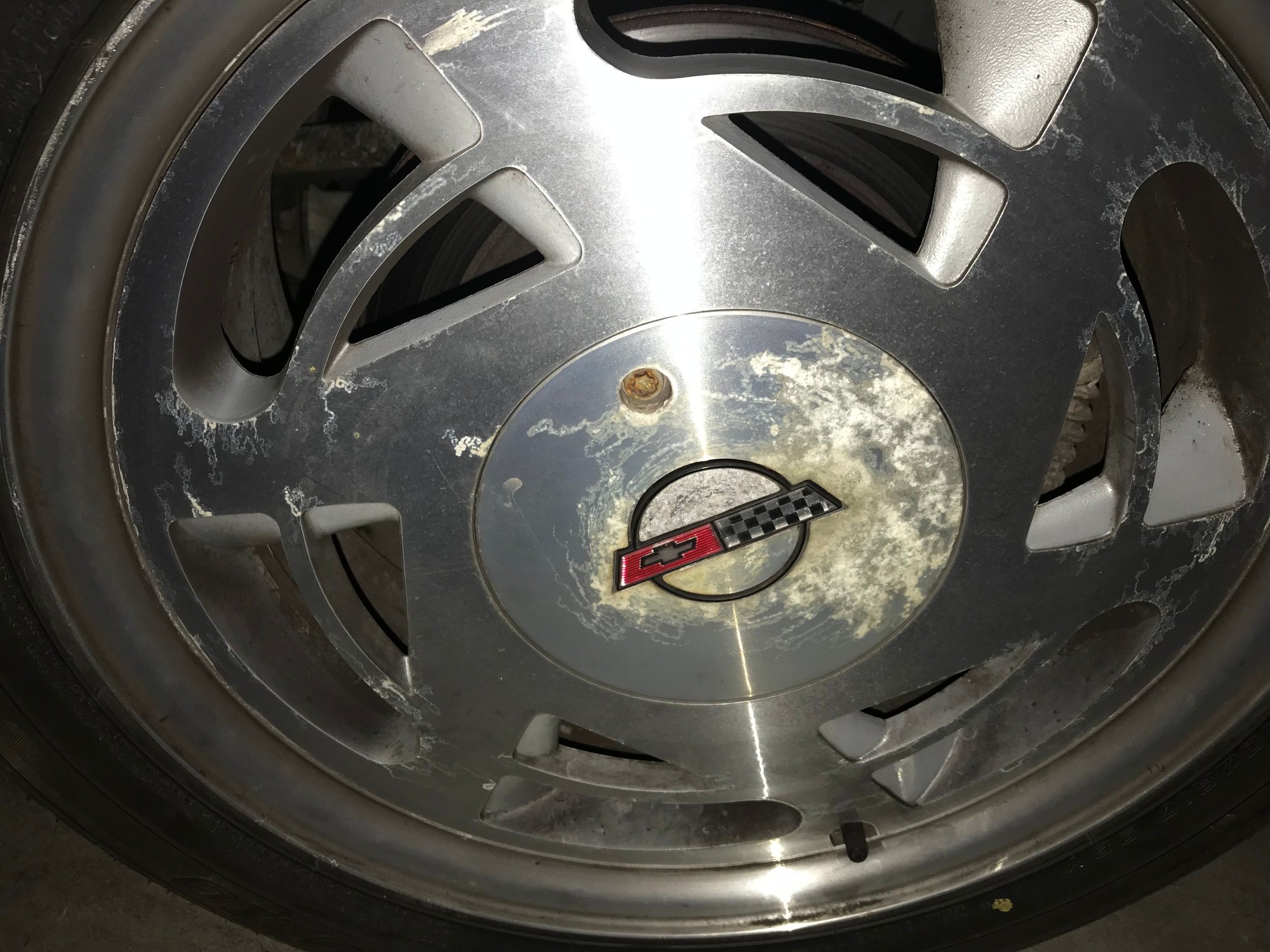

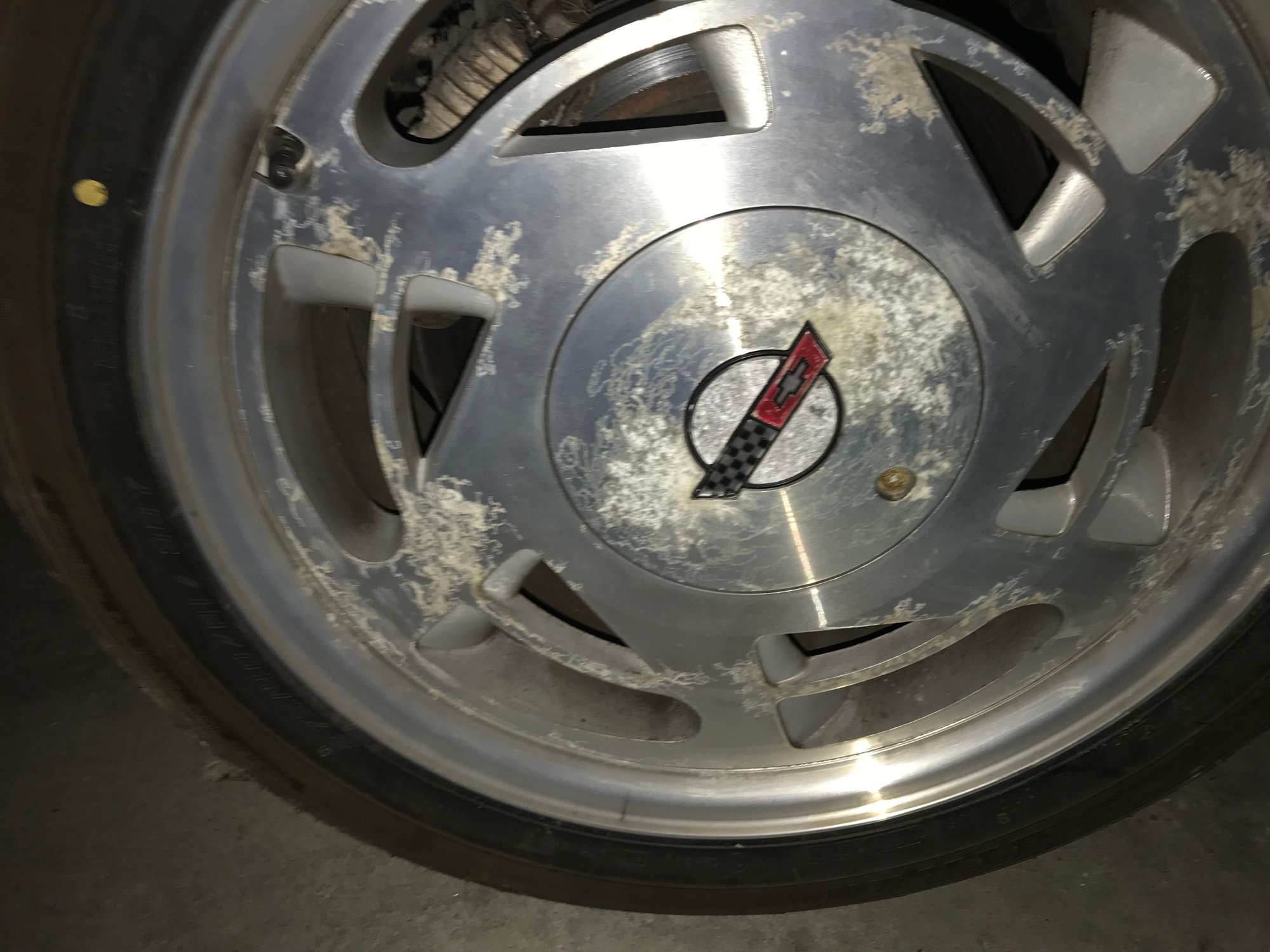

6: Need new rims as the ones on it are in bad shape with i think it is curb rash.

Could use 4 new ones? how do you repair these?

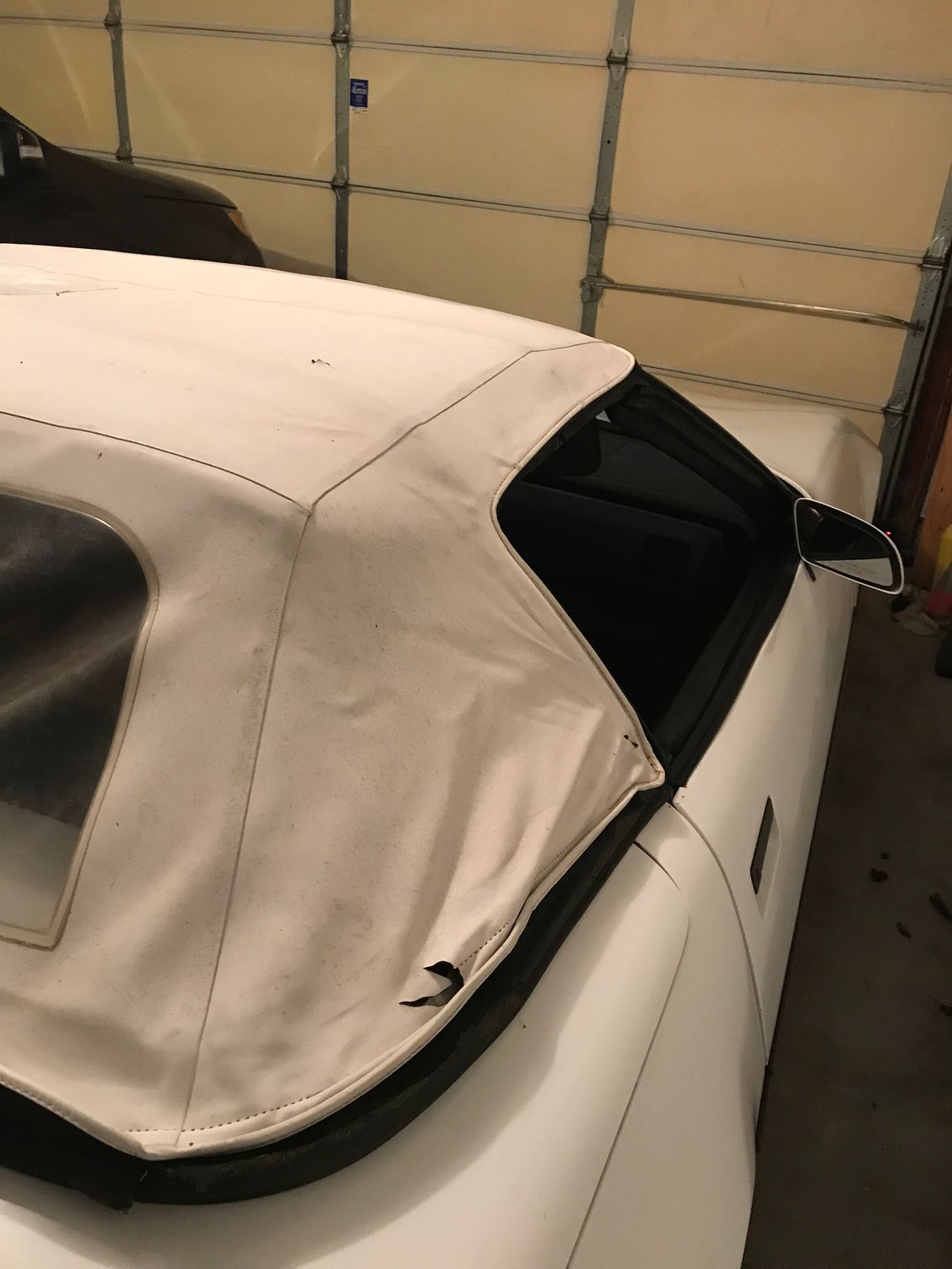

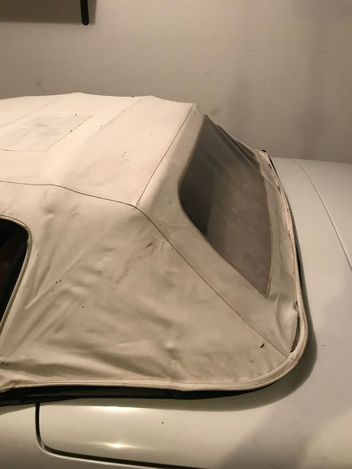

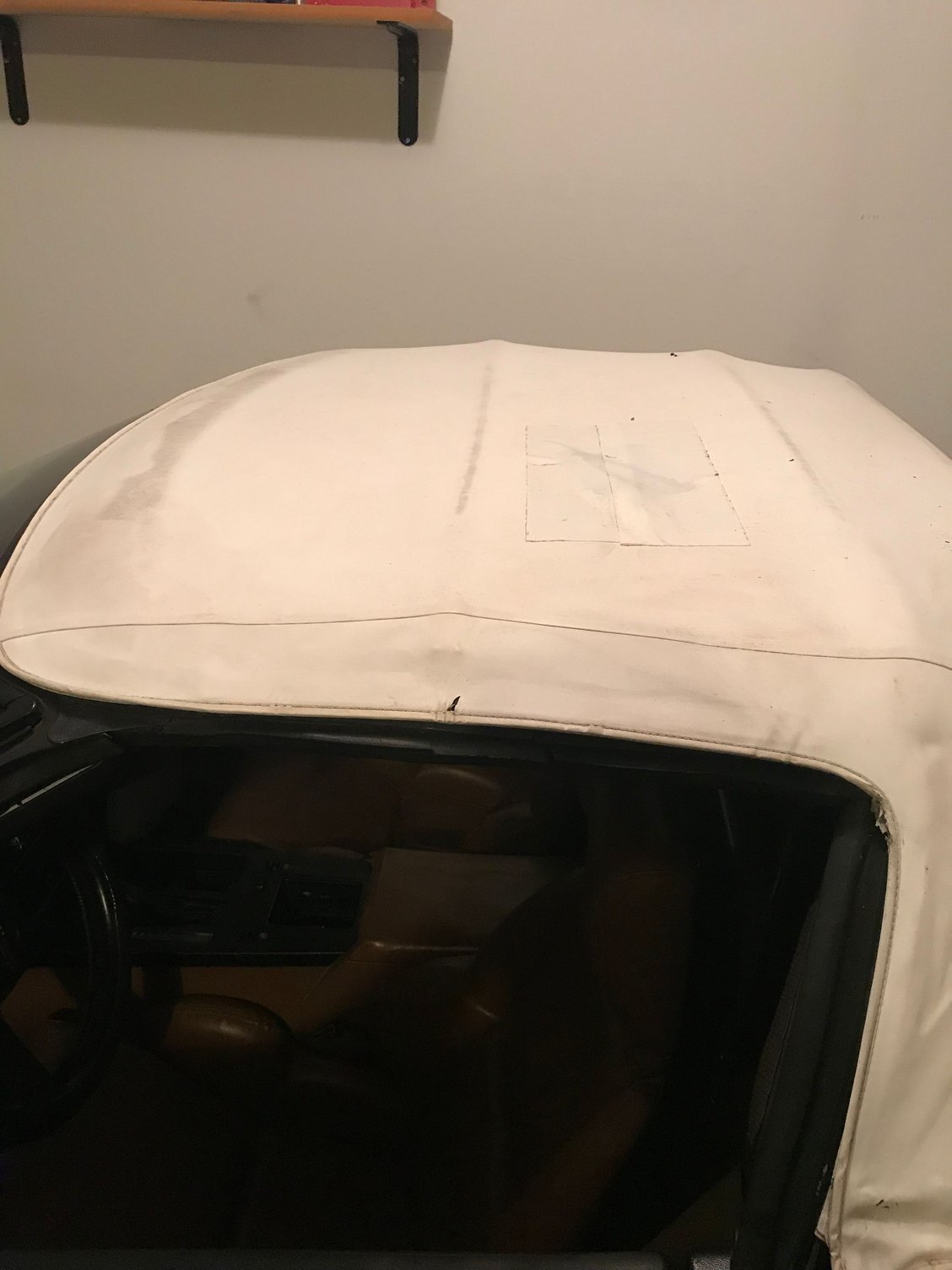

How to repair
dirty and ripped
rip
vinyl window
rip
Is this original top? Can you tell by the code?

-Looks like a glass rear window, don't think that was available in '89. My vinyl rear window has the build date stamped on it, OEM.
-Not sure about the price to install a new top. Tops with some h/w seem to run >$500. Find out what is included in that quote.

I just got a estimate for a new top from an installer in Omaha. Top and installation was $1400-$1500 depending on the condition of the frame & pads. That doesn’t include any new weatherstripping, headliner or cables. The top they would be using was an Easyon black stayfast cloth one with a plastic rear window. If you wanted a glass rear window it would be more. Kevin

rear window is vinyl. 1500 for new too but this guy will do it right. Great reviews. 147300 on the odometer. How much is a good deal?

That's not curb rash. The rims are clear coated and what you are seeing is the clear coming off. You can do them yourself as seen in the video or purchase new or reconditioned ones.

I so miss the clear coat stripper Eckler's used to sell in the brown glass bottle. That stuff was great.
