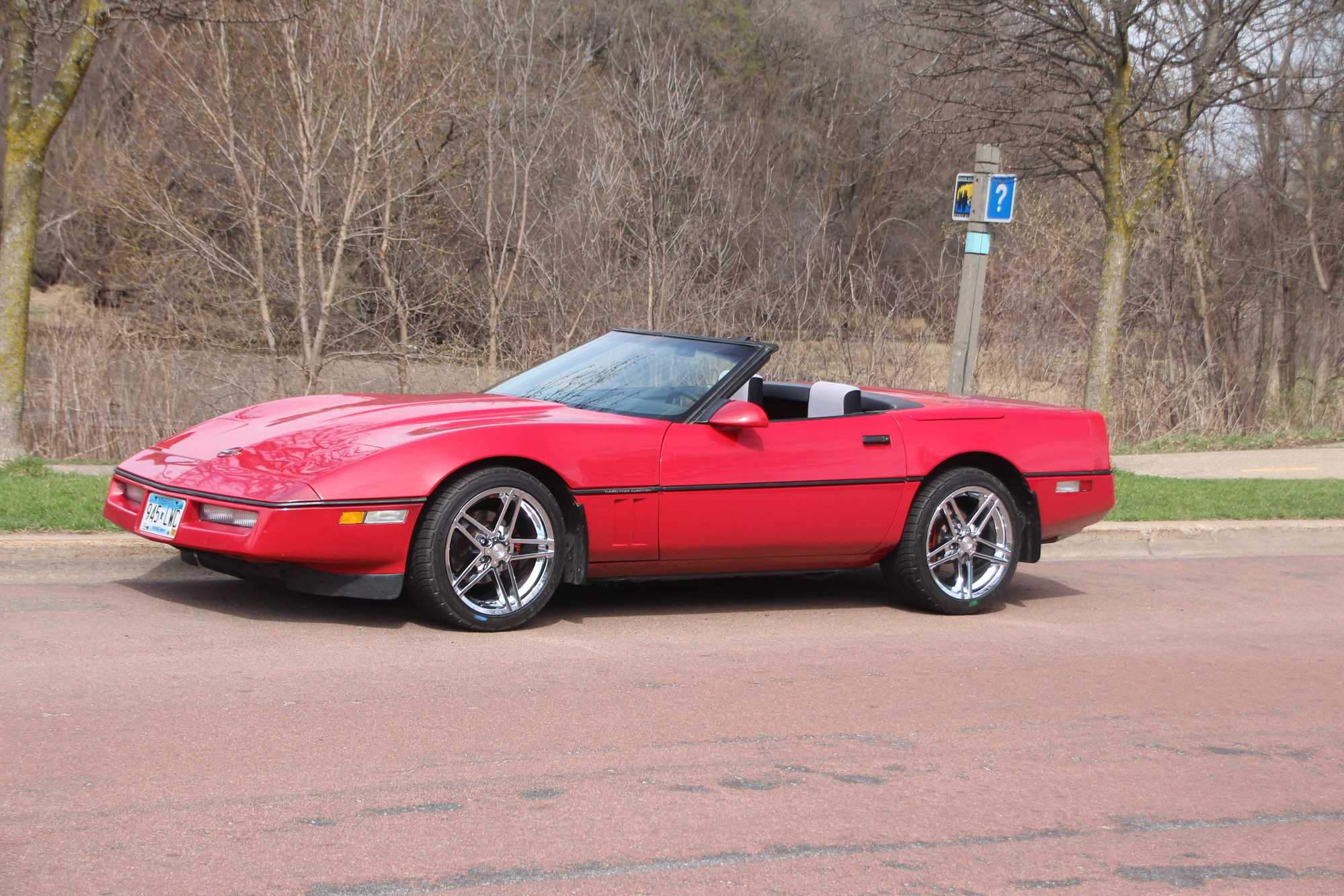

I changed the rims on my 86 about 2 years ago. I went with 9.5x18" 40 offset rims on all 4 corners and 255x40zr18 tires so it's a 4 square setup. They fit just like the originals did and there's a whole lot more options on 18" tires than 16". I wanted something that fit just like the originals did and these do. I've had no issues with them since putting them on. One advantage of this setup is if you ever have a problem on the road, you have a lot more options of getting a replacement than if you stayed with the smaller sizes.
Here's where I got he rims I put on my car: http://www.streetdreams.org/oe-replicas-wheels/
I have no connection to them, just passing along where I eventually found rims. It took a long time to find anyone that listed the size and actually had them.
I got what I think was a good price, style and quality, they were very knowledgeable and look great today.
Hope that helps
