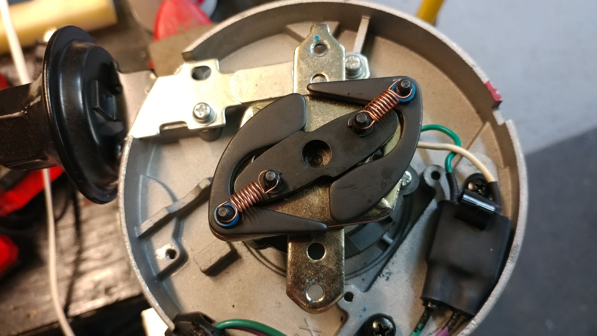

Built my engine 2 years ago. Built 383, Pertronix HEI distributor, Pertronix Digital HP box..... Car still isnt on road, hoping soon here (been driving up and down street to adjust wheels, etc)...Anyways, from day one engine was a little weird timing wise. Also heard a noise once in a while. Few weeks back changed springs to lighter ones. Lately noise has been more noticeable. Yesterday i had enough and jacked car up to pull shield off tranny cause it seemed to be coming from there, Nothing. Here is what i have going on....
1) Engine had a stumble off idle. Went through carb twice - nothing wrong there. Changed plug types twice - no change. Adjust HP box - no difference.
2) Engine idles a bit rough (to be expected with cam,etc) but would pull 20" vacuum at idle steady.
3) Plugs all even. Seems to run rich and then not so rich.
4) Would start perfect one time, then labor the next. Had nothing to do with heat. Was totally random.
5) On 2 different guns, the timing said it was 44 degrees at idle (impossible)
6) Noise seemed to be coming from distributor, but figured that wasnt likely.
So after inspecting tranny and a few other things, i pulled distributor to check the gear - was perfect. So now im like WTF is going on here. Then i noticed this...
Never would i have though this could be the issue. The center weight is upside down. The weights just flop around.
Im putting back together today, and hope my stumble-noise-timing is fixed. I wrote to Pertronix this AM, but dont think anything will come of it. I just want people to be aware of this.
I didnt see this when i changed the springs a few weeks back - i should have. But in my defense, im a Marine Tech, and boats dont use HEIs, or mechanical weights (not anymore at least). So i overlooked it. No excuse for not following the KISS rule.
Im done. I feel better now. Couldnt sleep last night was so pissed. Ill post an update later.
Thanks for reading!

UPDATE.
Noise still there but not as loud (actually i should say noticeable). The one weight still can move around a little and rattle. The other one is fine.
Stumble still there. Gotta still play around. But idle timing is now 22 and advances and starts fine everytime.
When or if Pertronix gets ahold of me im gonna tell them i want new weights and go from there.
In hind-site had i know i was gonna run a CD box, i would have gotten a small cap dist and remote coil. Oh well.

Well finally got around to calling Pertronix. I wanted a new set of bushings, but they said they dont have parts like that around. But they did offer to replace the unit, which was good. I just ran the engine again last night, and noise is there once it starts to build heat. But no skip or anything. Id hate to replace dist to have same noise. Maybe ill pull coil tonite to see if anything is going on. The noise is weird - almost sounds like a shuttering noise, or weights flopping around. Does sound like spark scatter, but no trace of it in the cap area. Cant tell if the noise goes away higher rpm as i cant hear it over the engine. This crap only happens to my stuff. I build and work on over 250 engines a year, and NEVER heard this noise.

Yeah originally when i found the plate upside down and weights flopping around, it seemed like that was my noise. Fixed it and seemed fine for a few minutes, then re-appeared. So, here is the symptoms...
- Noise in dist after it starts to get warm.
- Still running rich. Ive been through carb 3 times.750 VS that i milled choke tower off, 6.5 powervalve, #31 shooter, #70 primary jets, #75 secondary (added rear metering block, and jet extensions all 4)
- Stumble off idle, no matter timing and carb, still does it. Rich when i rev it up.
I have the digital HP box from Pertronix as well. I set the voltage to the lower setting, and no different. MDS is on. I asked if they had any issues using an HEI with the box and they said shouldnt be an issue.
It dosent sound like an arching coil, as thats usually a snapping sound. This is a shuttering sound. I have video but sounds nothing like real life.
I know its a PITA trying to see whats up when i cant even drive it but im reaching....If i can get both bumpers soon ill get plates on it so i can drive it at least into the huge school parking lot across from me.

Pulled cover and coil last night. No arching or anything else wrong.......
