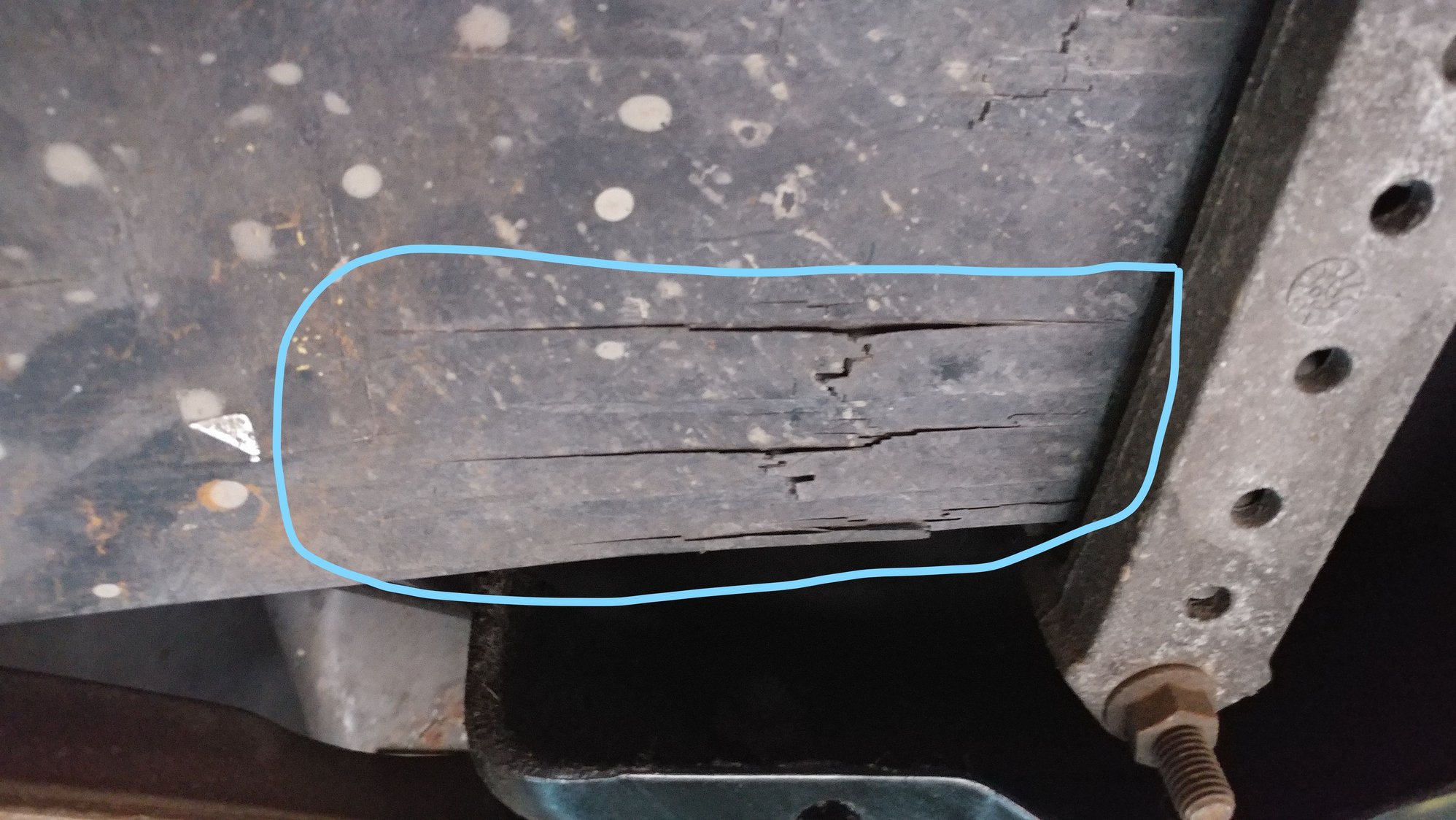

I took my C4 into a local Chevy dealer to have them put it on the rack and take a look replacing part of the air dam. One of the brackets is broken and the plastic is cracked. That is no big deal.
While up on the rack though we noticed that the front leaf spring is "peeling", that's the best way I can describe it, right in the middle on the bottom side (can't see the top just by looking). It isn't cracked through or anything but a thin layer of the composite is missing right in the middle for about 4 inches across and on either end I could get under it with my finger if I wanted and pull down more of that bottom thin layer of the composite.
The tech that was looking at it said "I have never seen that before". The spring will obviously need to be replaced but, how serious is that? Does the spring need to be replaced immediately?

REPLACE IT....if it snaps when you are driving it will be ugly. Is it like the attached picture? I bought a set from a forum member. Pull the codes off of the springs, do you have a performance suspension?( Z07 or Z51)
Thanks for your response.
Not quiet that bad, but kind of yes. I just found out that there is a corvette restoration shop not too far from me. I gave them a call and am waiting on a call back now.
No, it is a completely stock plain old 87 C4.

Yes time to replace it as it is the start of delamination and will only get worse. Be sure check the other spring also.

I took it into a local Corvette restoration shop to have the spring replaced but they called me today and said that they cannot find a new spring for it. They have a source on used ones but not new.
I asked them to give me a day or so to see what I can find but sure enough, I can't find one either. I can find the rear spring everywhere but no-one that I can find in a search has the front.
I ended up talking to a company called hyperco that specializes in suspension and does work with composite springs. The gentleman told me that there was only one mold for the OEM front spring and it was destroyed. To make another mold is cost prohibitive.
The last lead I got is to company called Van Steel out of FL. They are closed now and I will give them a call in the morning but their site also shows discontinued.
Does anyone else have any leads on a new front spring?

Update on this, I just got off the phone with Van Steel. There were two companies that were making them. One of them broke their mold somewhere around 2 years ago. The second went out of business. No new front springs are available. It sounds like Van Steel is doing some work to maybe start making them in the future but understandably, it will be a while.
Van Steel put me in contact with a company called C&S Corvette out of FL who has an inventory of good condition springs. My restore shop is going to get me the code off the spring. I am going to buy a used one from C&S and have it shipped over.
Also, I might know what happened to my spring.
C&S said that they don't wear out but acidic wheel and engine cleaner can destroy them.
When I bought the car from a local dealer (not a corvette dealer), the engine was looking bright and shiny and new. The spring is failing at the top of the arch, right under the engine. So it's very possible that someone along the way used an acidic engine cleaner, which then dripped down onto the front spring and damaged it.

It is true that certain detergents and solvents will destroy the transverse spring. Some say even Simple Green is too harsh... More than likely though its due to age and time. 32 years for any moving car parts is a long time. That spring flexes constantly... they can wear out like everything else. Nothing wrong with a good used unit either.

Update on this. My restore shop has a source that was at Carlisle and found the correct HMP spring in good condition. So it looks like I will be back on the road soon!
