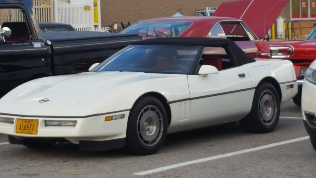

After two yrs of mishaps/illnesses/family accidents I am finally getting my 1986 convertible on the road. Sat in a garage for 5 yrs after 2nd owner passed away and I bought it 3 yrs ago. Went thru the car and changed all filters, fluids etc and just finished the exhaust...(had a straight exhaust which I hated. due to loudness so I went back to stock)......
Problem I have is: When it is daylight the dash lights can barely be seen....In your expertise what causes this and how do I correct it without breaking the bank........
Other issue is passenger headlight motor decided to call it quits so I bought the entire motor rather than replace the bushings...do I have to remove the entire assembly to replace old with the new??????????????

PS You have rim direction issues (swapped side for side).
Old Aug 2, 2019 | 11:53 PM
stabac's Avatar
stabac
Joined: Sep 2017
Posts: 429
Likes: 18
From: Slinger Wisconsin
On the inside of the rims it should be marked with proper position
