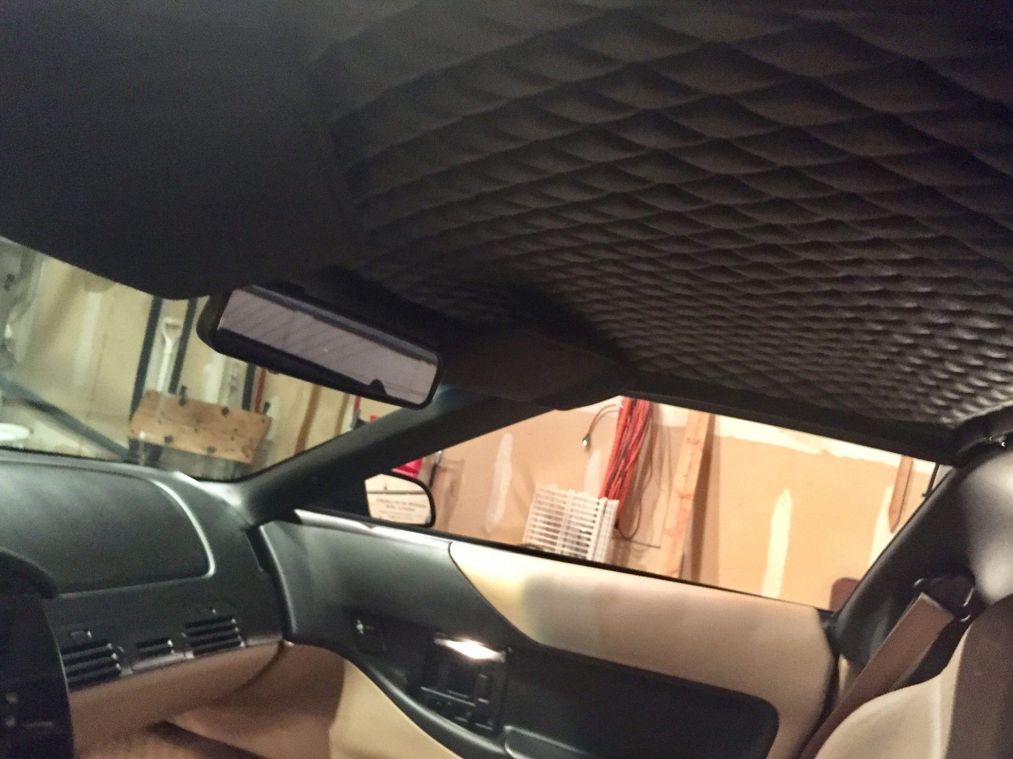

I had this done several years ago and have been quite happy with the results. I had it custom made and installed at an auto upholstery shop. It is patterned after the headliner in the 2017 3LT interior that has an approx 1.5" diamond pattern. Some folks like it and some do not. For me the really important thing is that I like it very much.

Obviously a great pic to demonstrate what can be done!

One interesting thing that I learned from my experience was that the "larger" the diamond pattern the less stitching is involved and thus a "relatively" lower labor cost. I preferred the smaller pattern although in the poor picture I posted it does look like a larger pattern than it really is.
Looks great Thanks for posting the pic.
