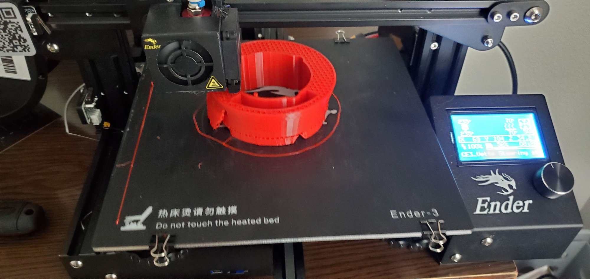

So I was trying to repair the tilt steering in my 90 coupe and guess what broke, the rear cover. so I have spent the last few hours trying to recreate it. If I can get the part completed I'll post the finished result

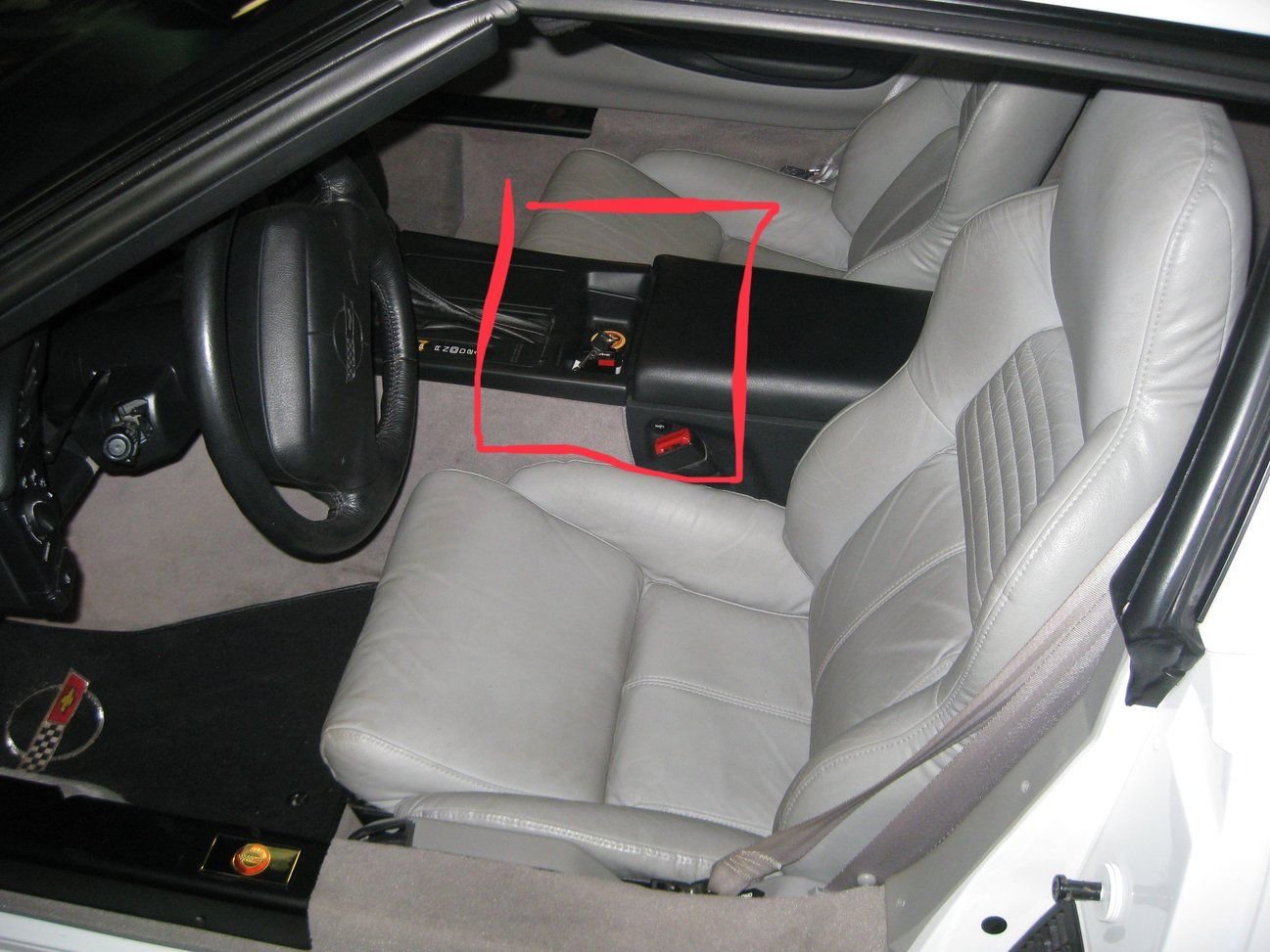

My cousin in law is also getting into 3D printing, so I tasked him with making me a hard to find part, the center console cubby for manual seat cars. You can see it in this pic below in the square. So far, he's only made me a rectangular tray out of the low end plastic to loosely set in there. If you want something else to try as a passion project, go for this!

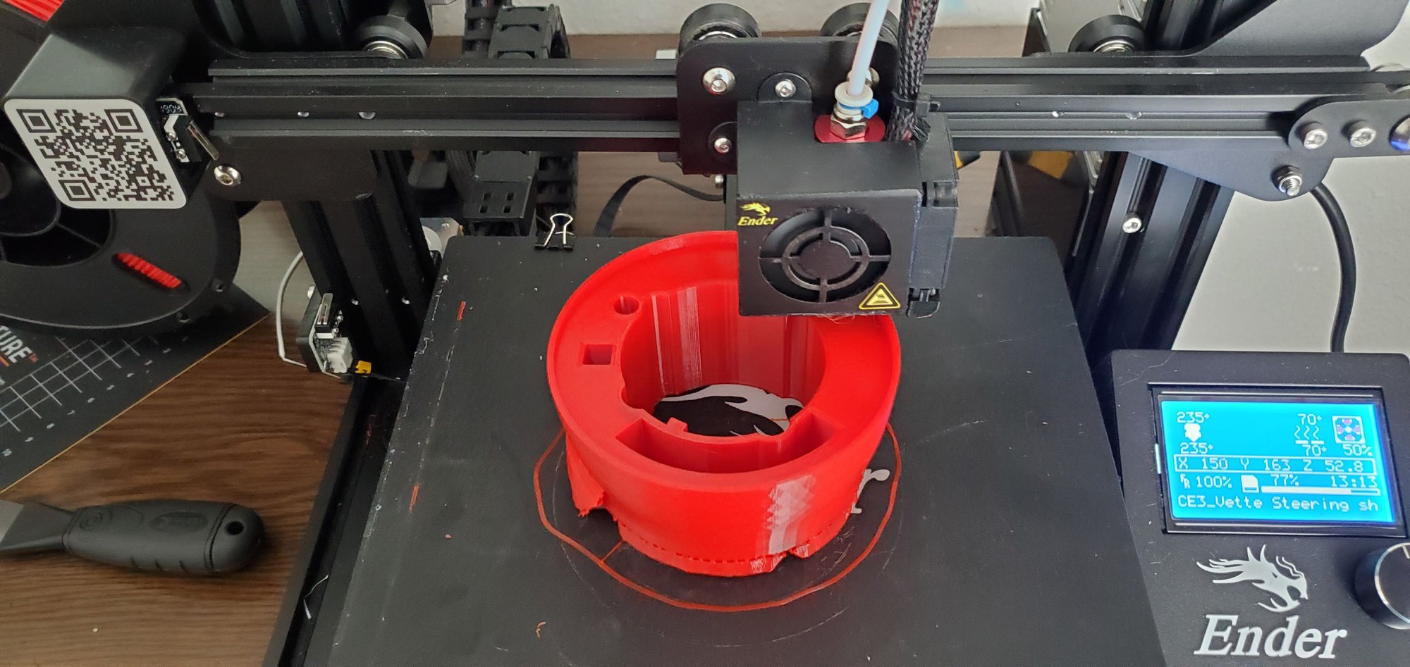

I will look into making a part for this. I have to test if my 90 shares the same mounting spot as a later year console.
But on the topic of the steering colum part here is how it's going.
My initial drawing last night
The print at 9am this morning (8 hrs 30 mins of print time)
13 hours down 4 to go

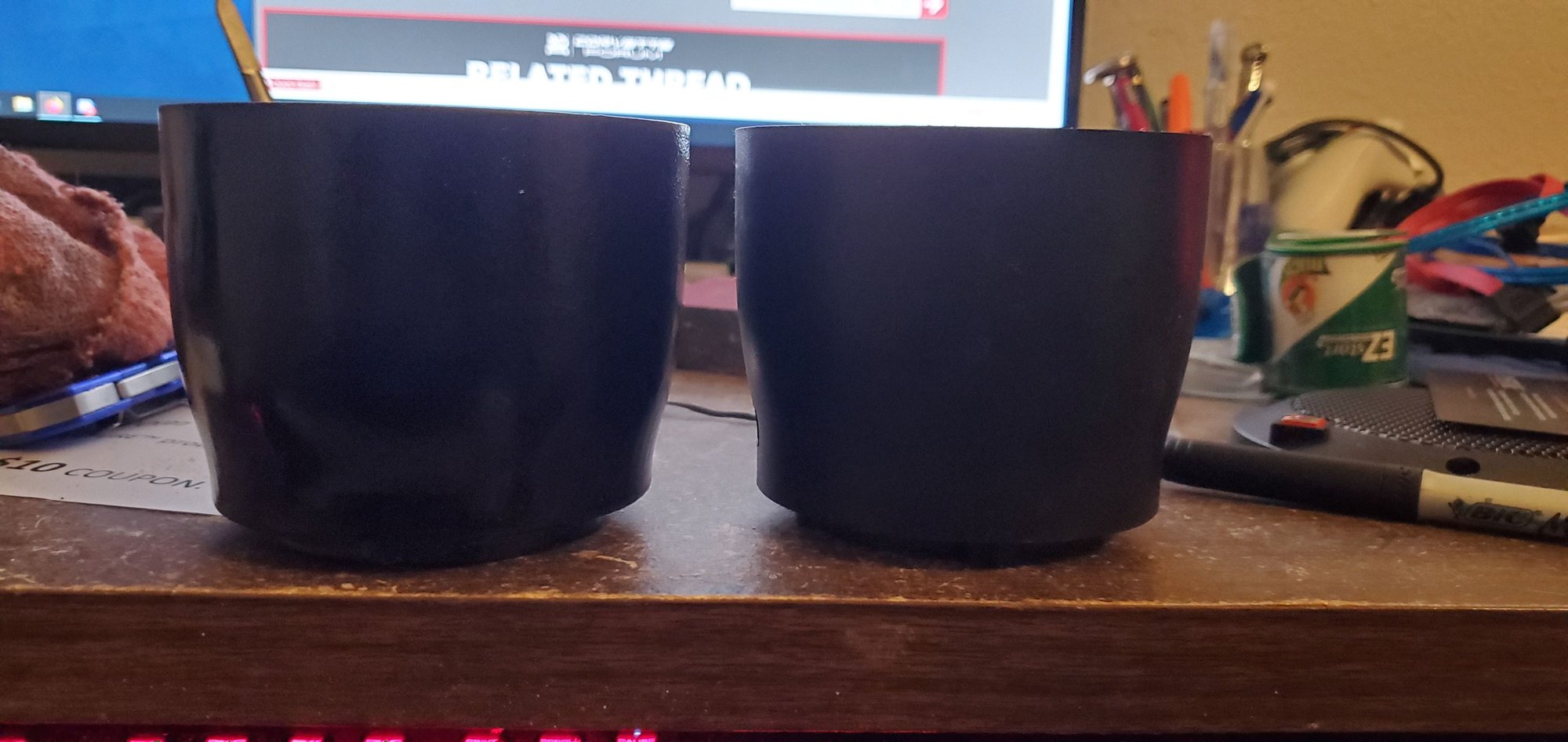

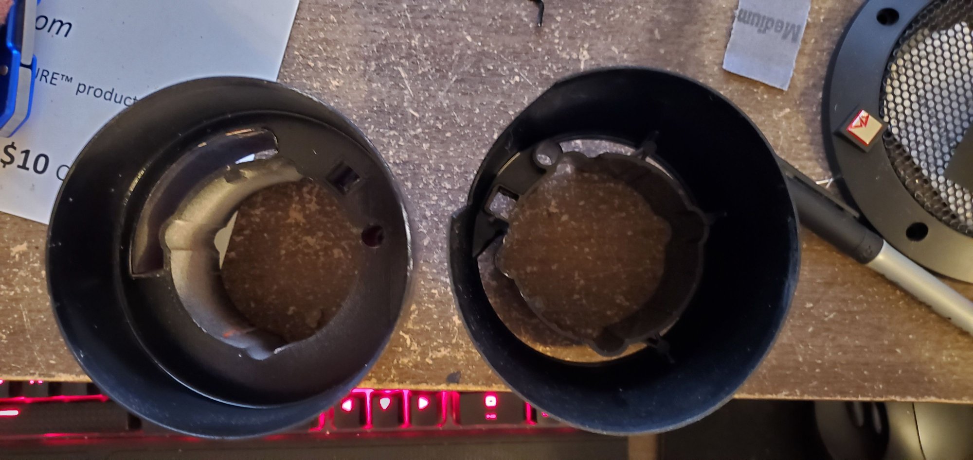

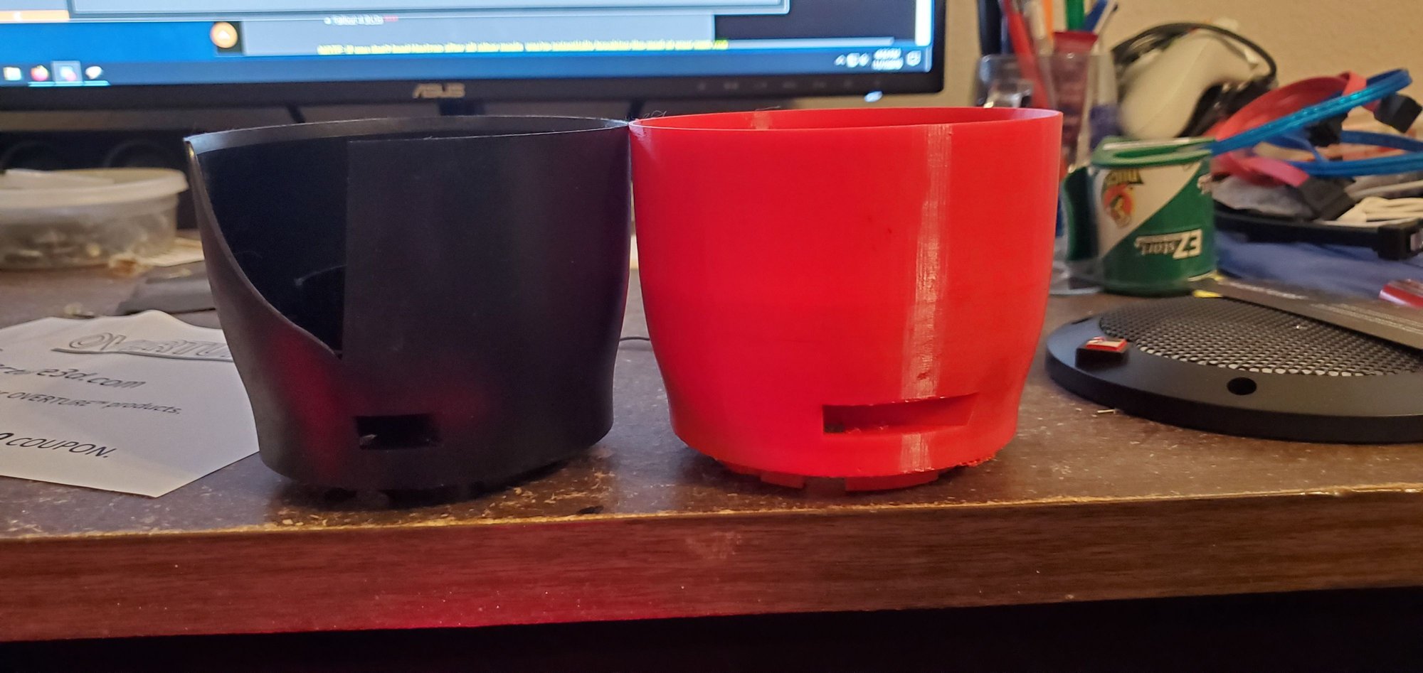

I am actually printing in PET-G for the part in red. Form what I can find it is a good compromise between abs and pla for qualities and heat resistance.
The finished product.
Sanded and painted
Some small changes for strength
