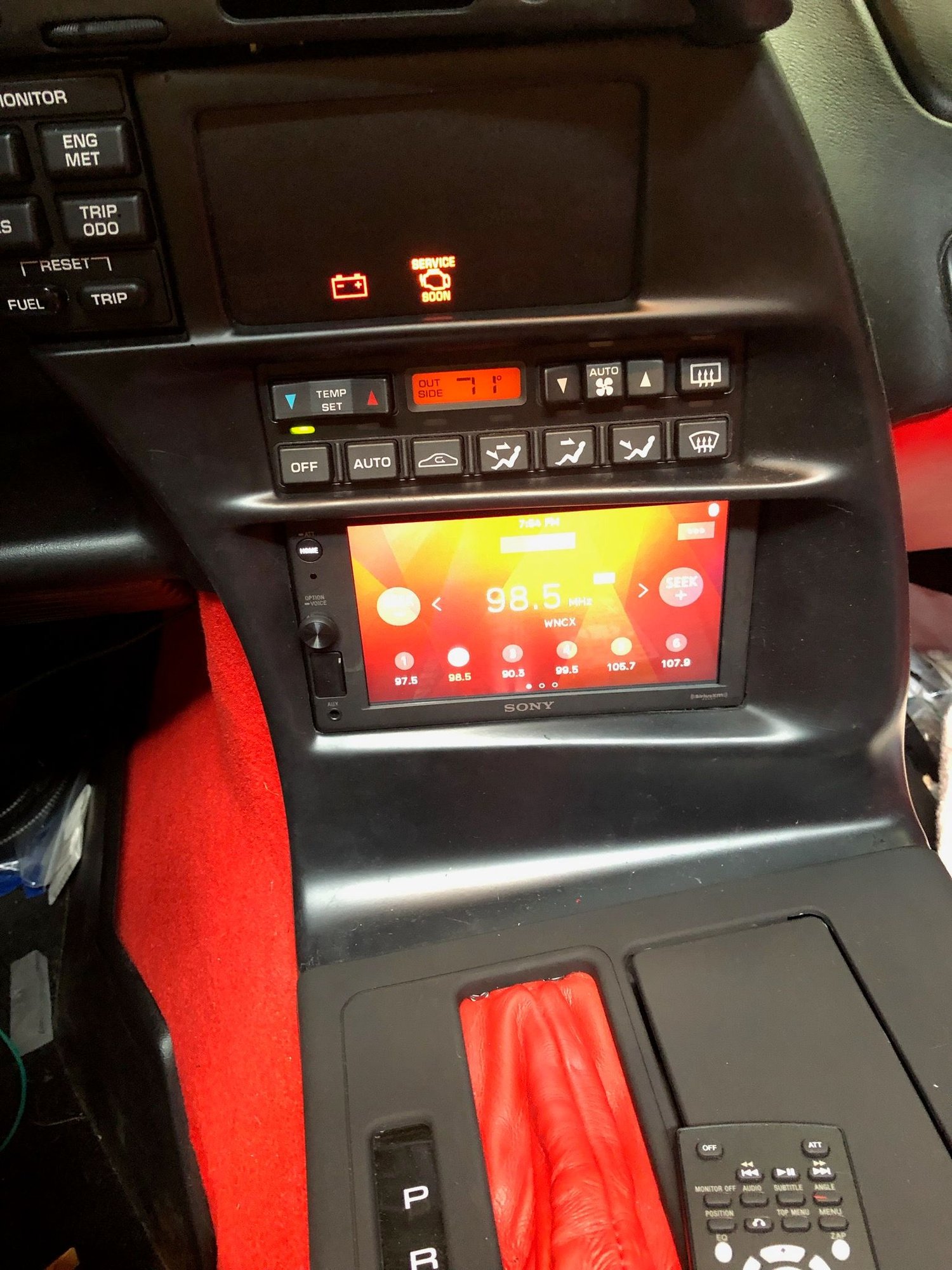

I actually installed the same head unit, but no backup camera (was thinking about adding one though). I chose the Sony unit because of the finish, color and overall look once installed. I also like the fact it has a physical volume ****.
This pic isn't the best, pretty dark and some shadows making it look like there are gaps, but the fit in the opening is pretty much perfect.
I appreciate your write up on running the wire, will most definitely come in handy for me.
