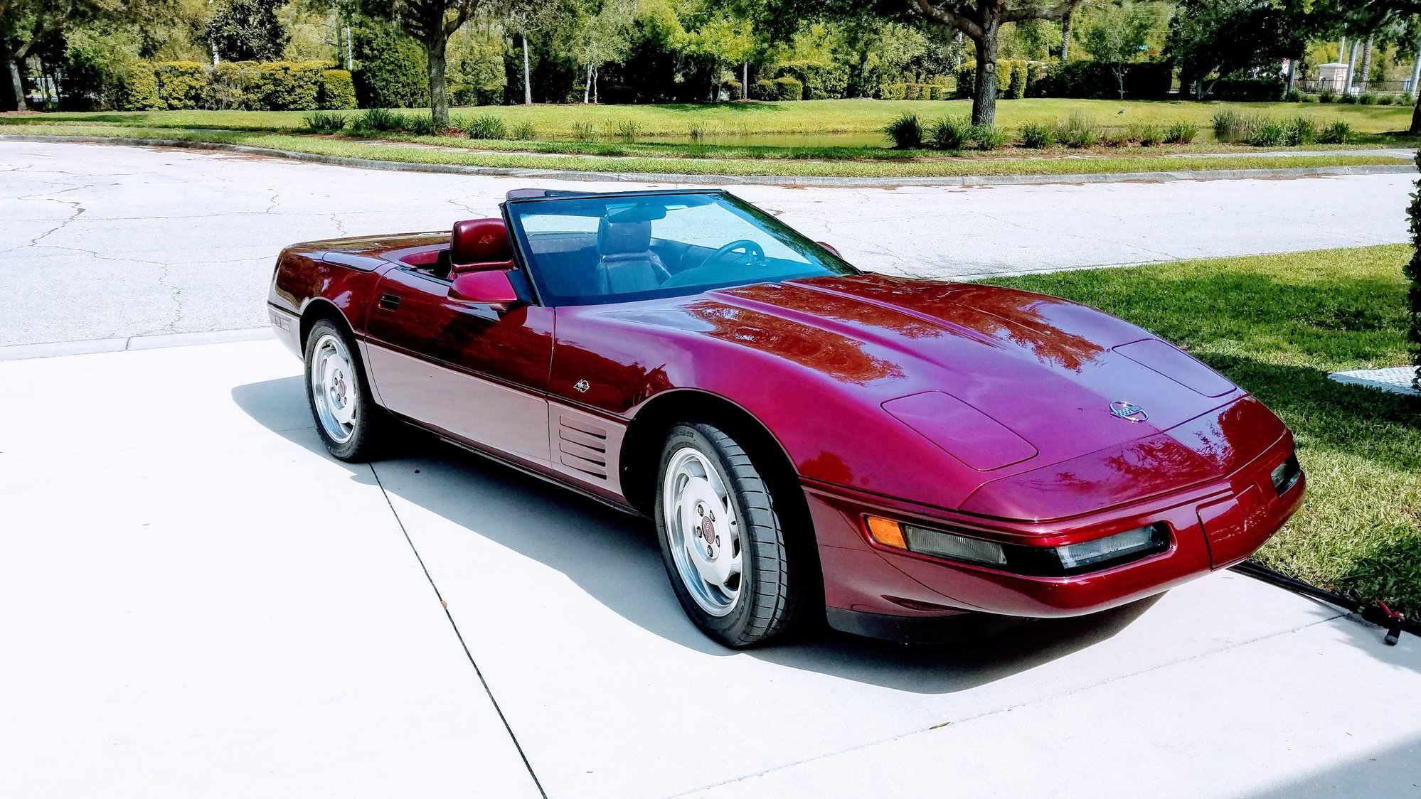

Default hush panel nut 93 c4
right on fiberbundle its a 93 ruby ragtop. you mention a parts catalogue thru 91. let me know what size the 91 is. it'll be a good place to start
thanks

Nice Ruby!
