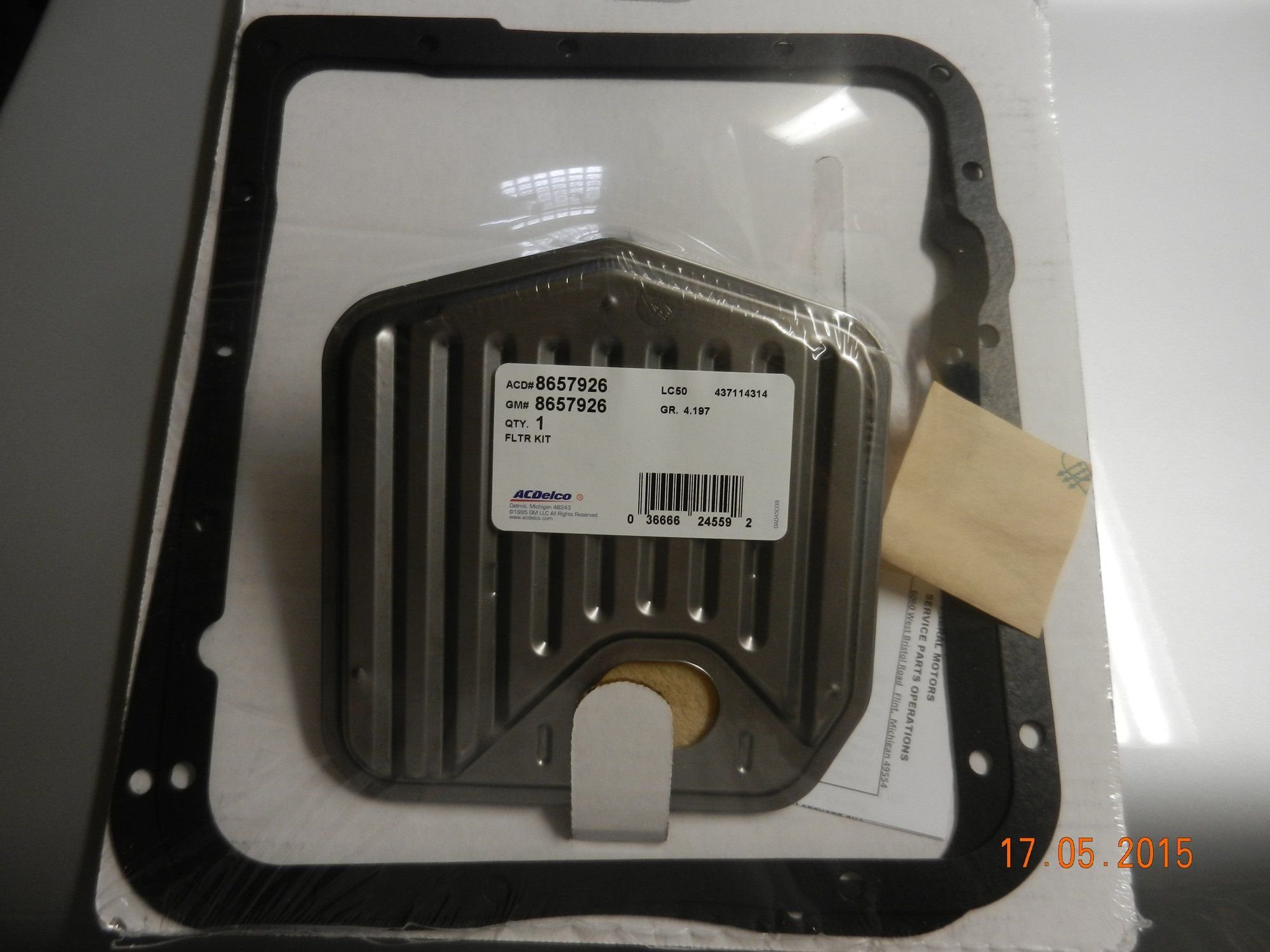

Originally Posted by ihatebarkingdogs
Be sure the shape of your new filter is exactly like the one in Joe C's post above. There is another filter for the 60e (electronic transmission) that is similar but the shape is different AND the neck that goes in the pump is slightly larger in diameter than the 700 filter. You'll never get it in.
side note -- the service replacement filter, GM /delco part number 8657926 is for the 84-93 700r4 transmission. using genuine GM takes all the guess work out of it -
