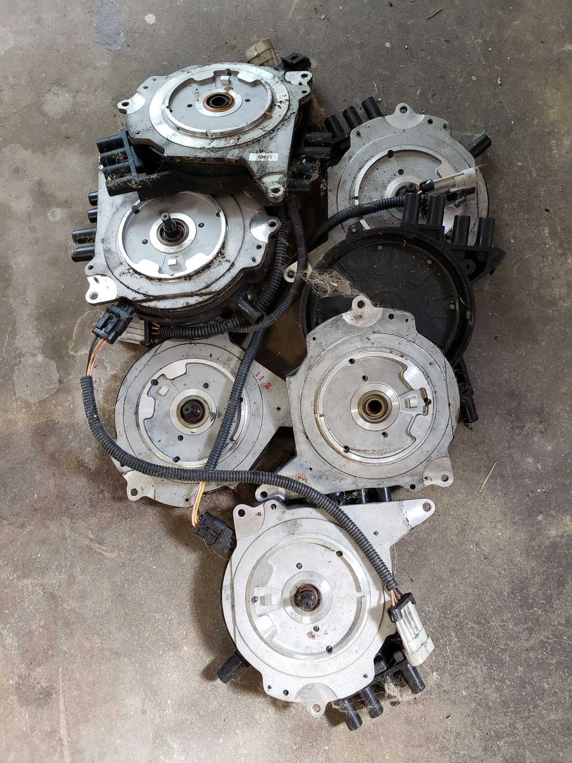

Cleaning out the garage today. This is 286K miles worth of '94 Opti Sparks.

Thats a lot of optis. Using the same type each time?

Time for the LTCC swap
One of those lasted about 30K after I installed the LTCC.
Mostly Cardone. They last anywhere from about 5K to 50K, as I recall. It's a crap shoot.
286K is a lot of miles, too

Any of those still have a Mitsubishi optical module in them? If so, they're probably worth salvaging.
Really? Once you do the swap they just become a crank sensor, right? What failed?
I'm curious, because my 92 has an invented (supposedly much worse) opti and made it 130k on its own opti, I replaced that as PM and due to incorrectly diagnosing what truly was a Vats issue. You're a bit over double my mileage and have used WAY more of them than I have.

As I recall, the original Opti made it to about 125K before the before the bearing went. The rest are all aftermarket.
I'm not sure what failed. It just started the classic intermittent engine stalling problem. I changed the Opti and the problem went away.
I'm not sure how many miles are on the latest Opti. I don't drive the C4 much anymore since I bought the C5.
Cam sensor, actually, but same general idea. After the LTCC conversion, a failure would likely be either the optical sensor or the shaft bearing. It's no longer a distributor after the LTCC is installed, so it won't need a rotor. There'll be no high voltage to distribute.
