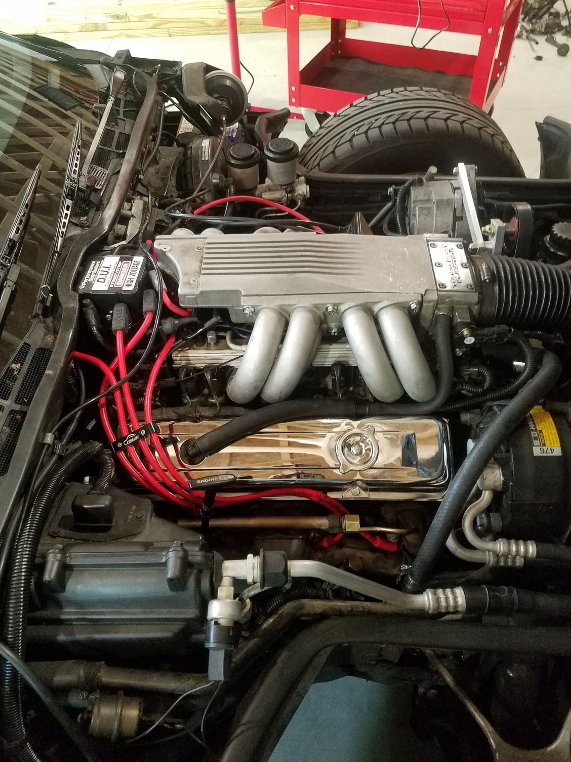

Here's what a deleted AIR system and throttle body bypass looks like:

1. I deleted the entire AIR system apart from the risers off the exhaust manifolds, plus the entire EVAP system and did the throttle body bypass. The prior owner deleted the cats and blocked off the EGR.
2. Got the bronze colored fittings at Lowe's.
