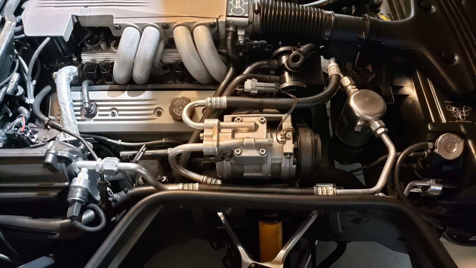

My 88 35th Anniversary Edition (L98):

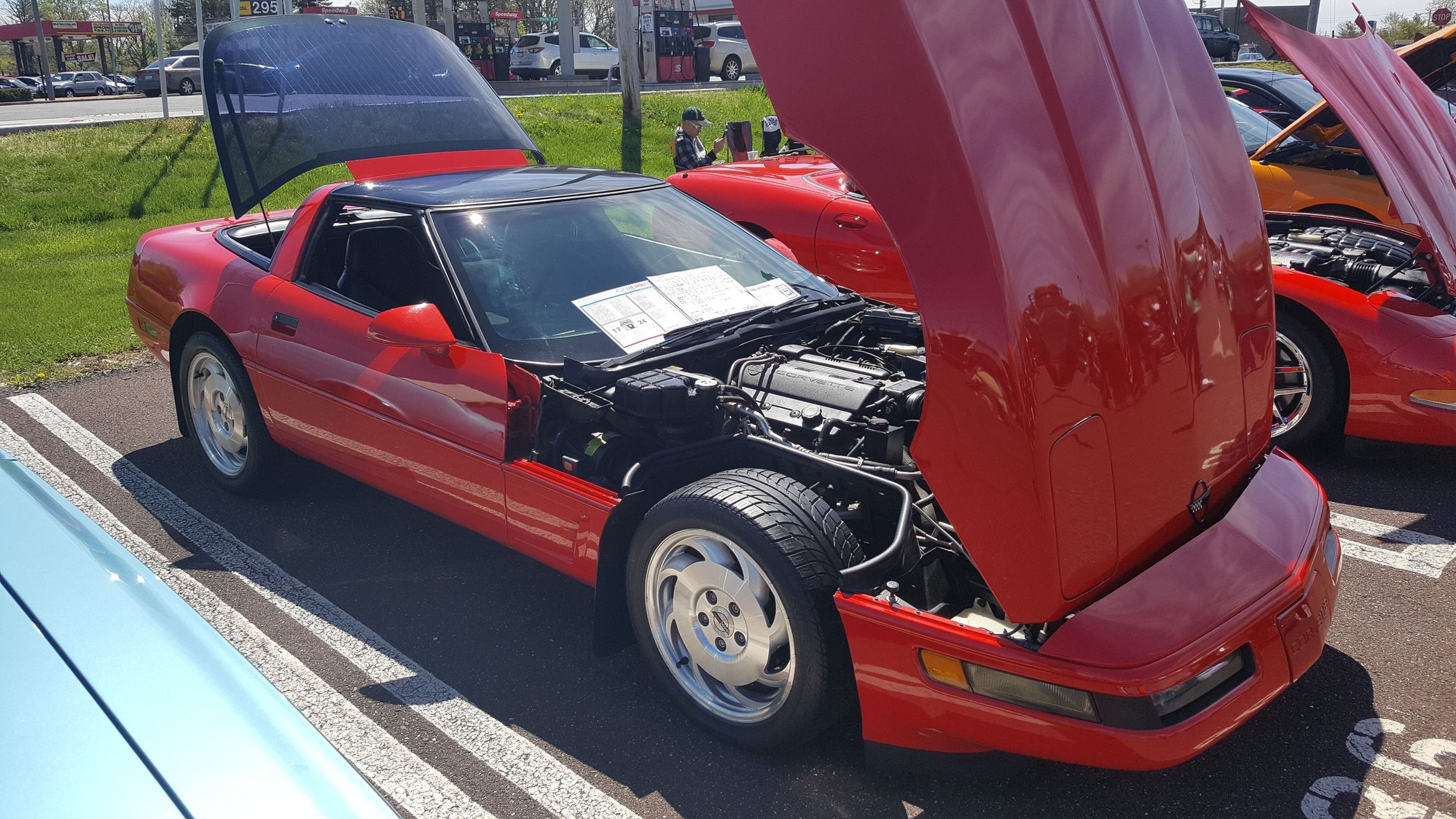

My 94 (LT1): (sorry not a close up)

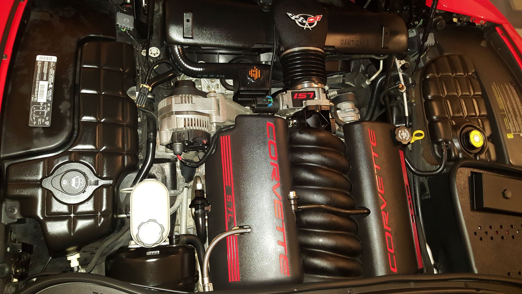

My 02 (LS1):

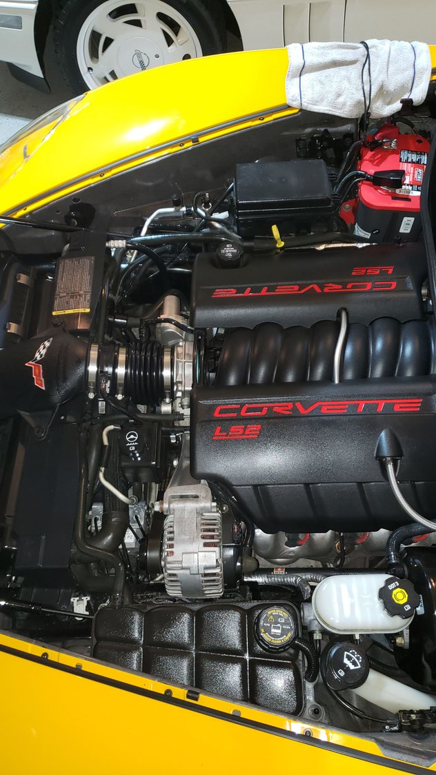

My 05 (LS2):

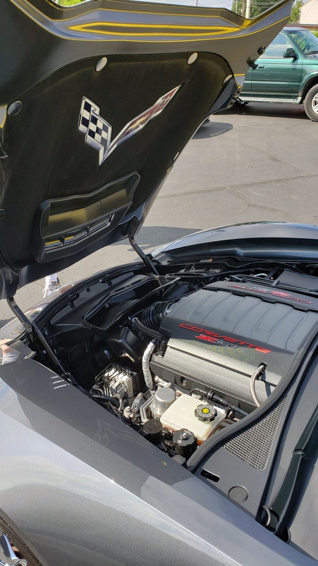

My 14 (LT1):
