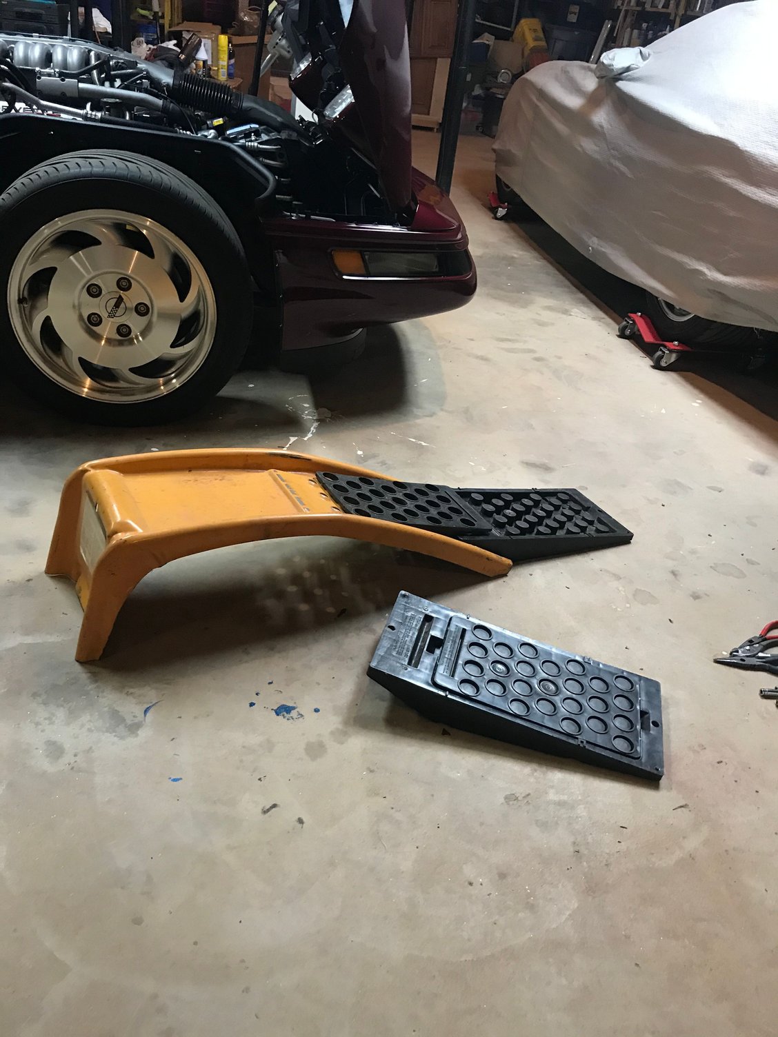

I have limited experience wrenching on cars, so please be kind haha. I have a 2.5 ton low profile floor jack and the heavy duty black rhino ramps which are at too steep an angle to drive my c4 up on. I want to use the floor jack to pick up the front corners, one at a time, and place ramps under the front tires one side then the other. Can someone please tell me if this will work, or if I'll end up having to pick up the front corner so far it will lift the back as well? Will lifting one corner far enough to get a ramp under the tire put too much torque on the car, or be unsafe in any way?
I've read every thread I could find on jacking a c4... but couldn't find anything about placing it on ramps like I'm thinking about doing.
At this point I'm just wanting to do an oil change at the end of the season, and maybe look at how hard it is to get at the O2 sensors. Jack stands are in my future.... but id like to be able to use my ramps for now if I can get the car onto them.
Additionally, yes I know that I can just drive up onto the ramps, and the front air dam will flex and it'll allegedly be fine. I still don't want to do this. I'd rather avoid having to build pre-ramps as well. At that point I'd probably just buy jack stands.
Thanks for any help!

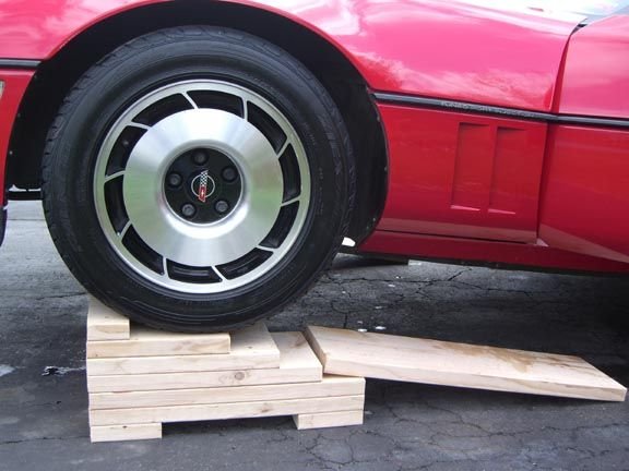

have you tried a couple pieces of 2x8 in front of the ramps

I have 2 x 6's with 3/4" x 6's very firmly attached to the bottom of the 2 x 6, The 3/4" being longer than the 2 x 6, so the tires anchor them down, so they can't scoot! Then I can slide my floor jack under the air dam to the center of the front X-member to lift the front of the car. Then I place my two supports under the car and lower the jack. Be sure to place the supports under the steel frame, not the fiberglass floor!

I have an old set of steel ramps and these pre-ramps for them. Not sure if they make anything like this for the new plastic ramps. only issue is my rear tires are a bit wide for the ramps.

I either use boards, as the other folks above have said, or I get out the big Leggo blocks we have for leveling our travel trailer. They work absolutely great for building a "pre-ramp".
Our driveway slants down from the road. Up at the end I can put the front wheels on the ramps and the car will be level to do oil changes.
I also have a 1 car garage. If I have to put the car on ramps, I do it outside where there is more room. I do put it on jackstands in the garage though.
