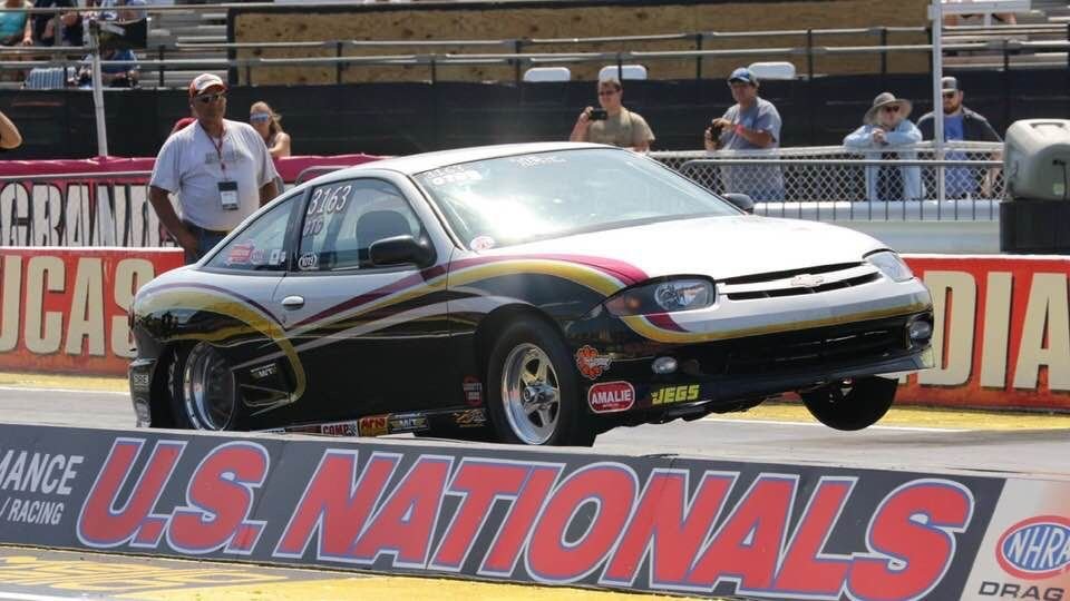

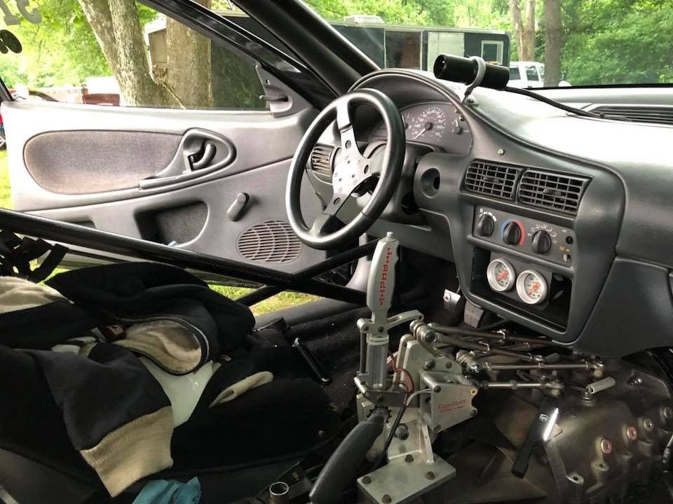

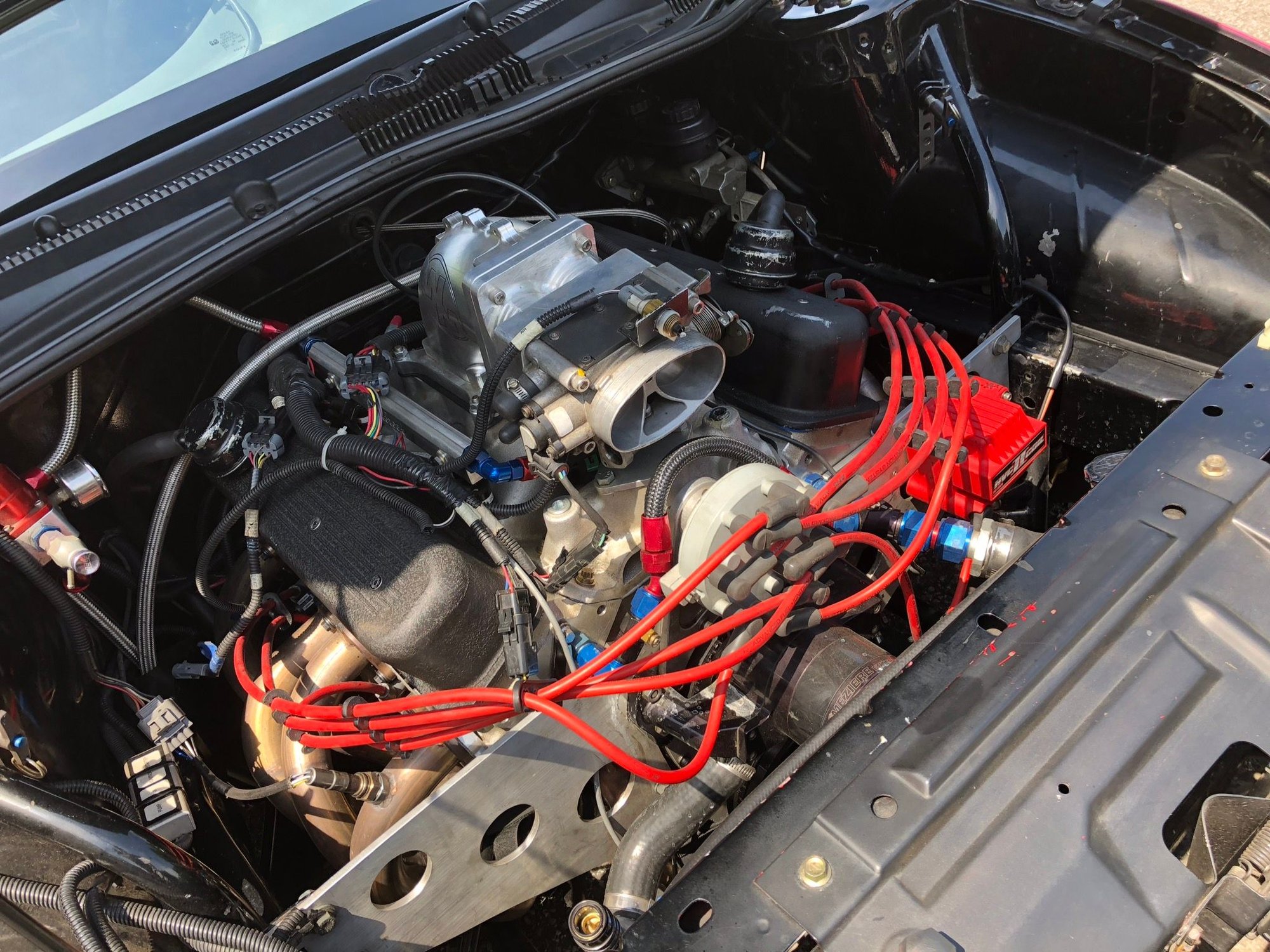

I race NHRA stick and superstock and race an LT4 five speed engine and a LT1 five speed in GT class ( in a Chevy Cavalier race car)
