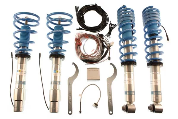

Nov 25, 2019 | 08:21 PM
Aren't there aftermarket cabin controlled systems available?
Bilstein B16
Reply 0
Nov 26, 2019 | 09:33 AM
Quote: Aren't there aftermarket cabin controlled systems available?
Bilstein B16
Sure, but they cost more than the car itself.
