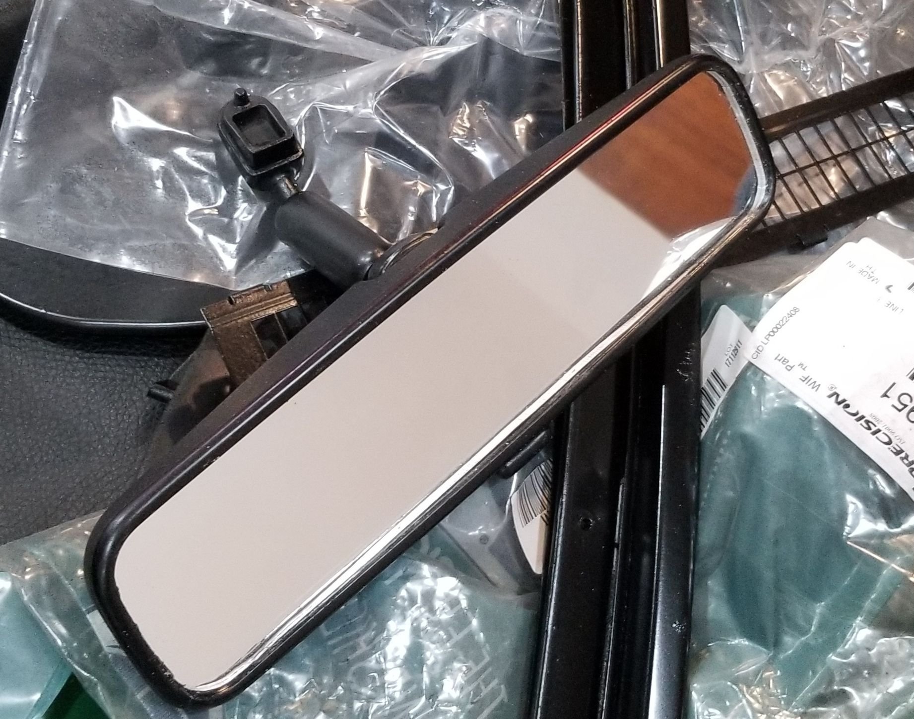

My silver backing was peeling on my 85 vette and did the old ebay search for a new one. I couldn't believe the prices even for a used one. So I decided I would give it a shot in repairing mine. I purchased a 10.00 piece of plexiglass mirror. I measured it twice and cut once and with a little trimming I got a perfect fit. Something you guys might want to consider before buying a new or used one....

That looks really good and great thought. Thanks for sharing.

That looks nice! You do realize the day/night function won't work, though. That takes a special manufacturing process, with tapered glass that's thinner at the bottom of the mirror.

Thanks, I know and not an issue, I rarely use it anyway....
