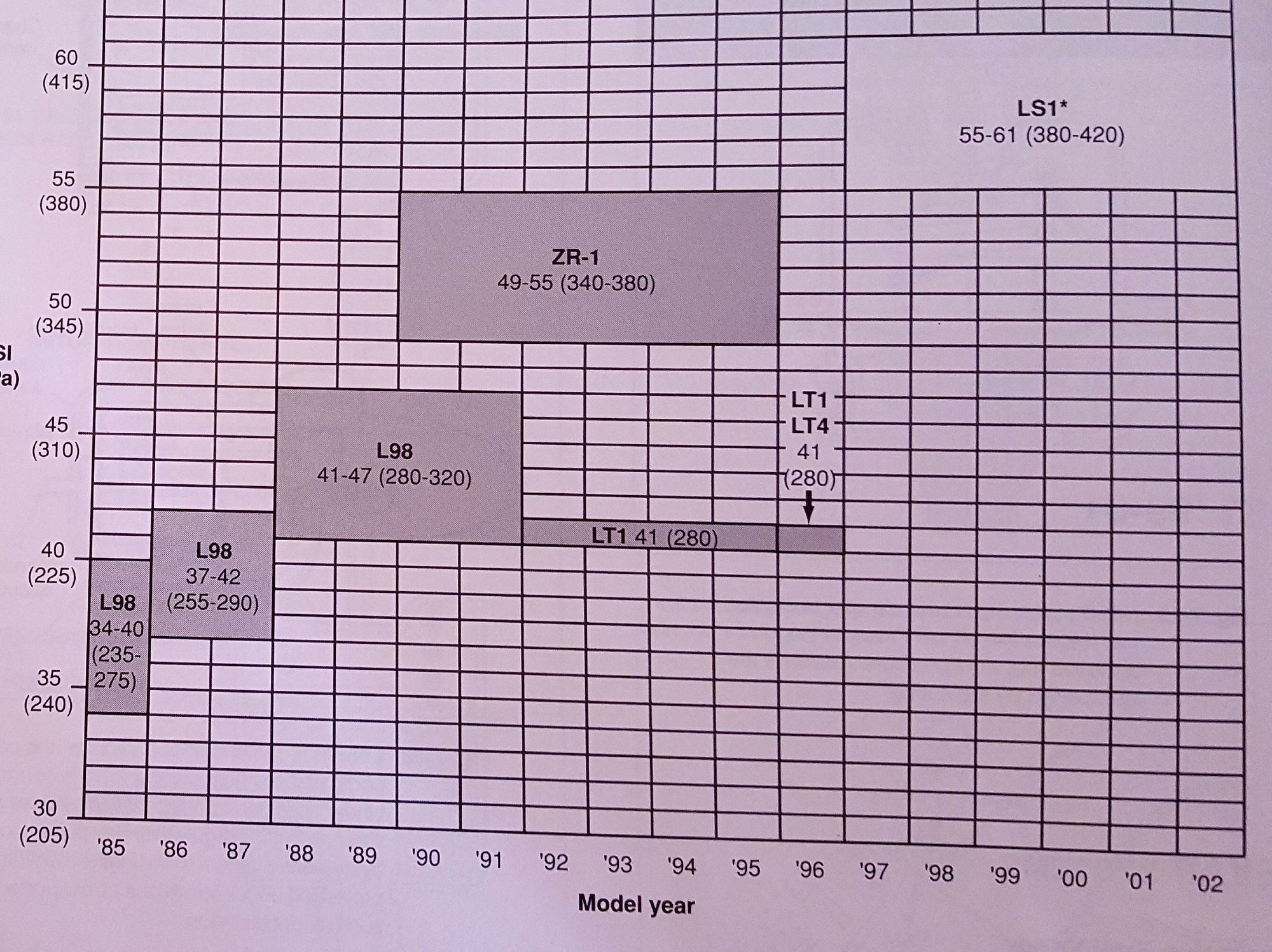

According to my Corvette Fuel Injection source by Proobst,, the fuel pressure range for the LTx motors is very narrow - in the 41-42 psi range, whereas the L98s, LSx, and others, the fuel pressure ranges considerably according to throttle position.
That said, I defer this question to someone like Mathew who has a handle on the specific LTx motors behavior.
Far as your leak down test results go, normally the pressure should remain within a couple pounds for 15 minutes or so as long as a component in the delivery system is not leaking, including the injectors, fuel lines and connections from the tank to the fuel rail and regulator, and the check valve in the pump. The readings you got indicate something is seeping a little. However, it doesn't appear to be anything that would cause a catastrophic failure (e.g., affecting all cylinders) like you're experiencing. There may be a hint of "coming attractions" foretold by your leak-down test, but FLOODING is not what you've described. Instead, fuel STARVATION is more in line with what you've described. But, have you examined the plugs for signs of flooding or leaning?
Taping a fuel pressure gauge to the windshield and taking the car for a drive while you (or a passenger) monitors the pressure under various % of throttle and RPM will show if you have a delivery issue or not.(LT5 test shown, refer to FSM for fuel rail Schrader valve location on the LTx motor.)
