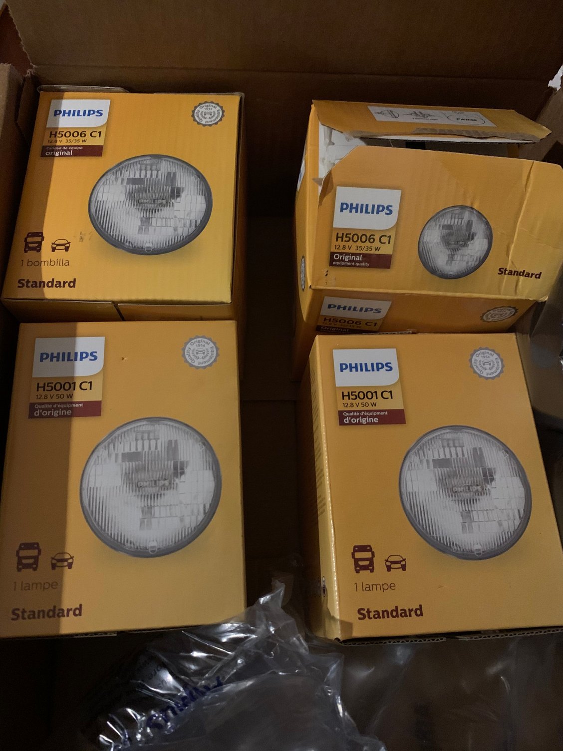

I ordered new halogen lights and thought there were 2 different lights. One for bright, 1 dim. Ordered 2 different part numbers (2 of each) and received 4 of the same light from amazon. Are there 2 different lights needed?

I'm seeing two different lights: two H5001 C1 and two H5006 C1
That's two part numbers, two different lights, in my book. One is for high, the other for low. I believe that the 5006 is for low beam.

The way I read it, you received two H5001 (Hi beam) and two H5006 (Hi and low beam). The H5001 has two terminals on the back. The H5006 has three terminals. What don't I understand about your problem?
