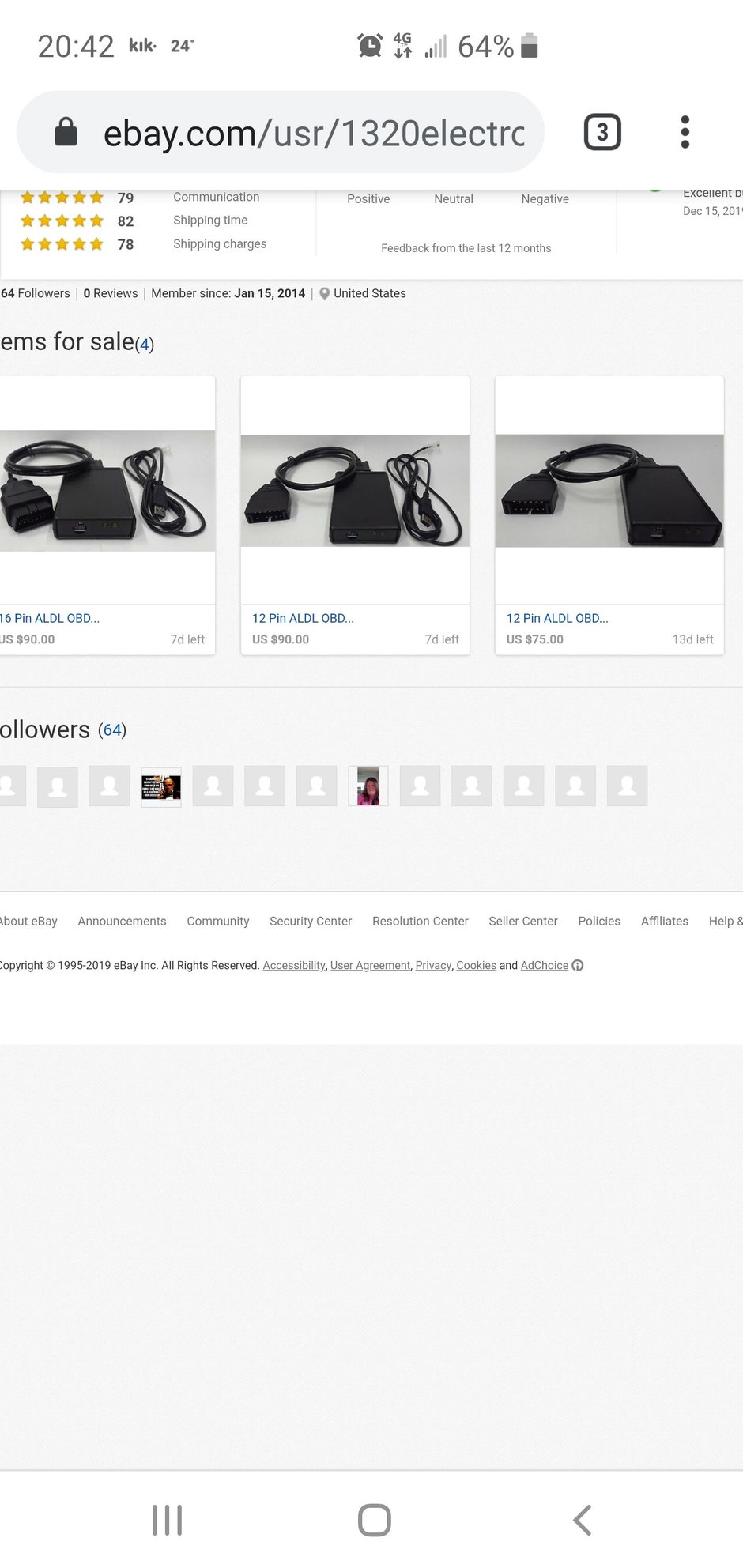

http://www.1320electronics.com/12pin_ALDL_BT_MK2.html

That page doesn't seem to list a cost for that scanner. And idea what it costs?
$90. Go to the eBay store and buy

Thanks. The website just directed you to PayPal, with no information on a price...I'm old fashioned in that I like to know how much something costs before being directed to pay for it.
