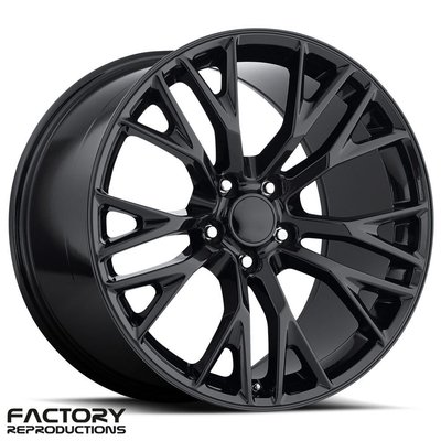

I bought some factory repro wheels that were 18x9.5 +40mm offset for 900 bucks. These are for my "cold weather" set up. I live in North Alabama so cold weather is highs in the 40's. I mounted 4 of these 285/35ZR-18 MICHELIN PILOT SPORT A/S 3+. The tirerack has 22 different tires in this size.
Here is the link to the wheel: https://factoryreproductions.com/sho...e/2015-c7-z06/

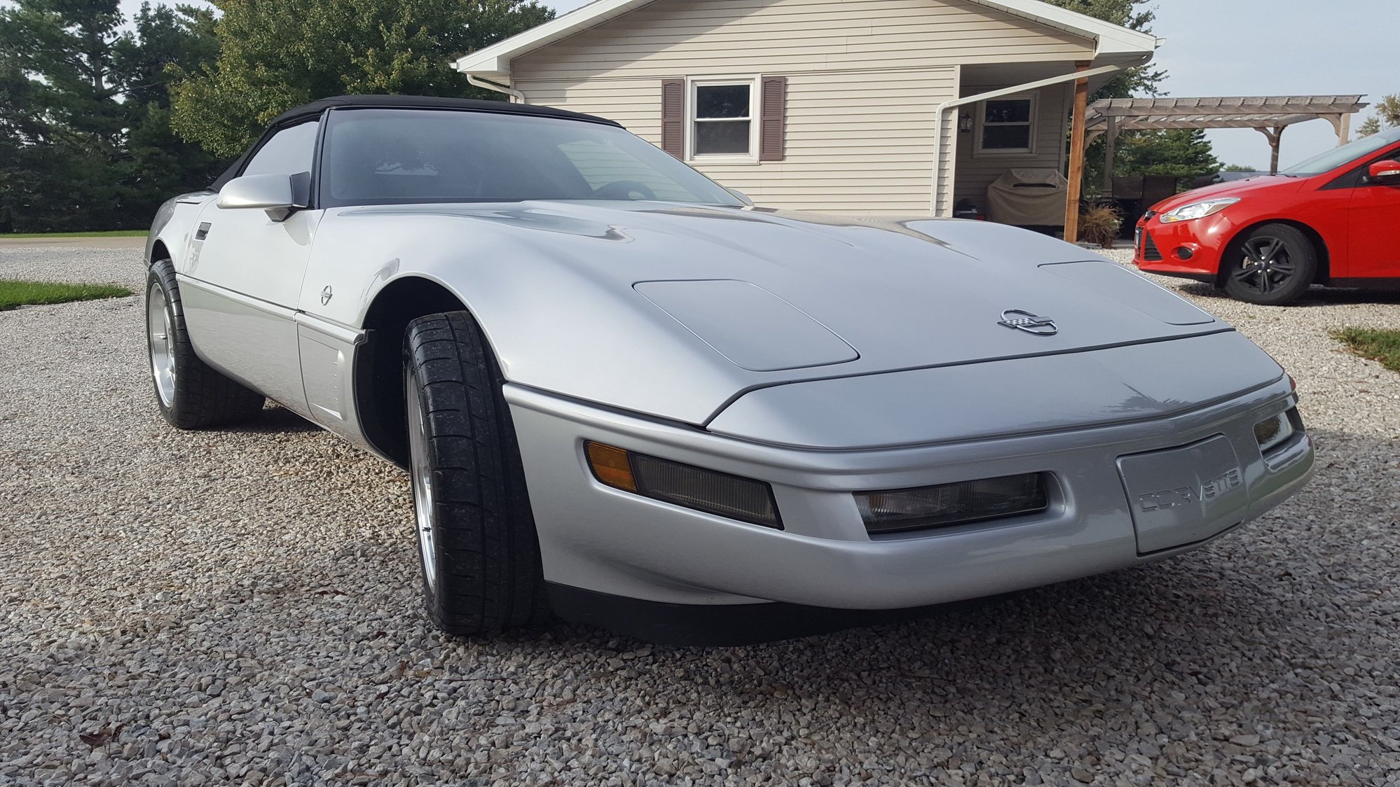

Oh yea, I had some Toyo R1R's in 225/45/15 on a hot rod NB Miata. They measured super wide at the tread compared to similar tires...functionally similar to 235 width.

Not to my untrained eye, PG. They don't push the limit of the flares, but look good within them. Got the car being worked on at the moment or I'd take a pic for you. Hope to get her back next week, will do so then.
