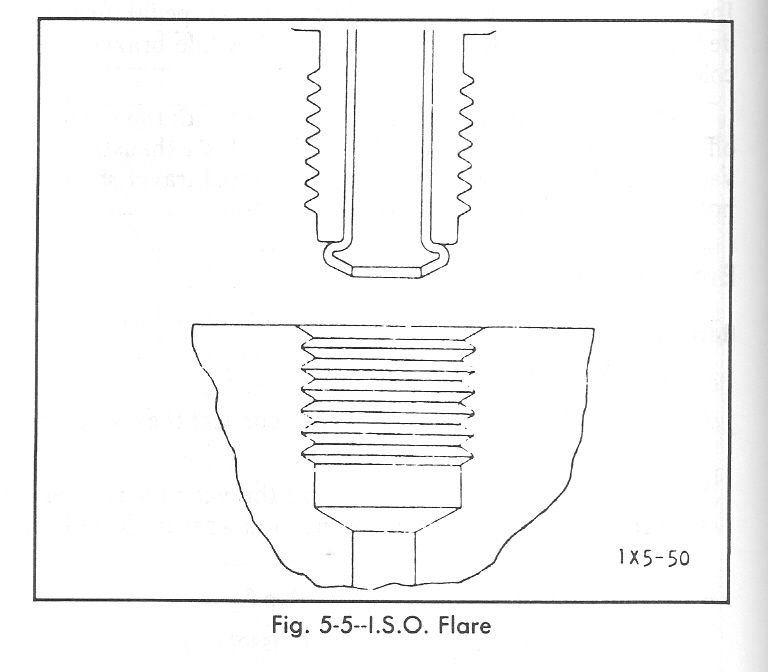

Replacing front pads on my 1988 coupe.Being my first time for this work,I have a question re the hose that mounts to the caliper.Is the end of the hose that attaches to the bracket
where the brake line is just threaded on as it appears to be ? Also is there a seal at this connection ? Can a metal clip (squealer) be on each pad -or only the inner ? TIA

Yes, it just screws on. There is a copper washer that does the sealing. Should be replaced when removed. Usually only one pad has the warning clip, but it wouldn't hurt anything as long as it fits on both sides.

Originally Posted by cv1988
Is the end of the hose that attaches to the bracket where the brake line is just threaded on as it appears to be?
There is a copper washer at the caliper end of the brake hose, but I think cv1988's question is at the other end of the hose. The brake hose is threaded, and mates to a "bubble flare" fitting on the steel brake line. Support the parts carefully to avoid twisting the steel brake line of the chassis.
