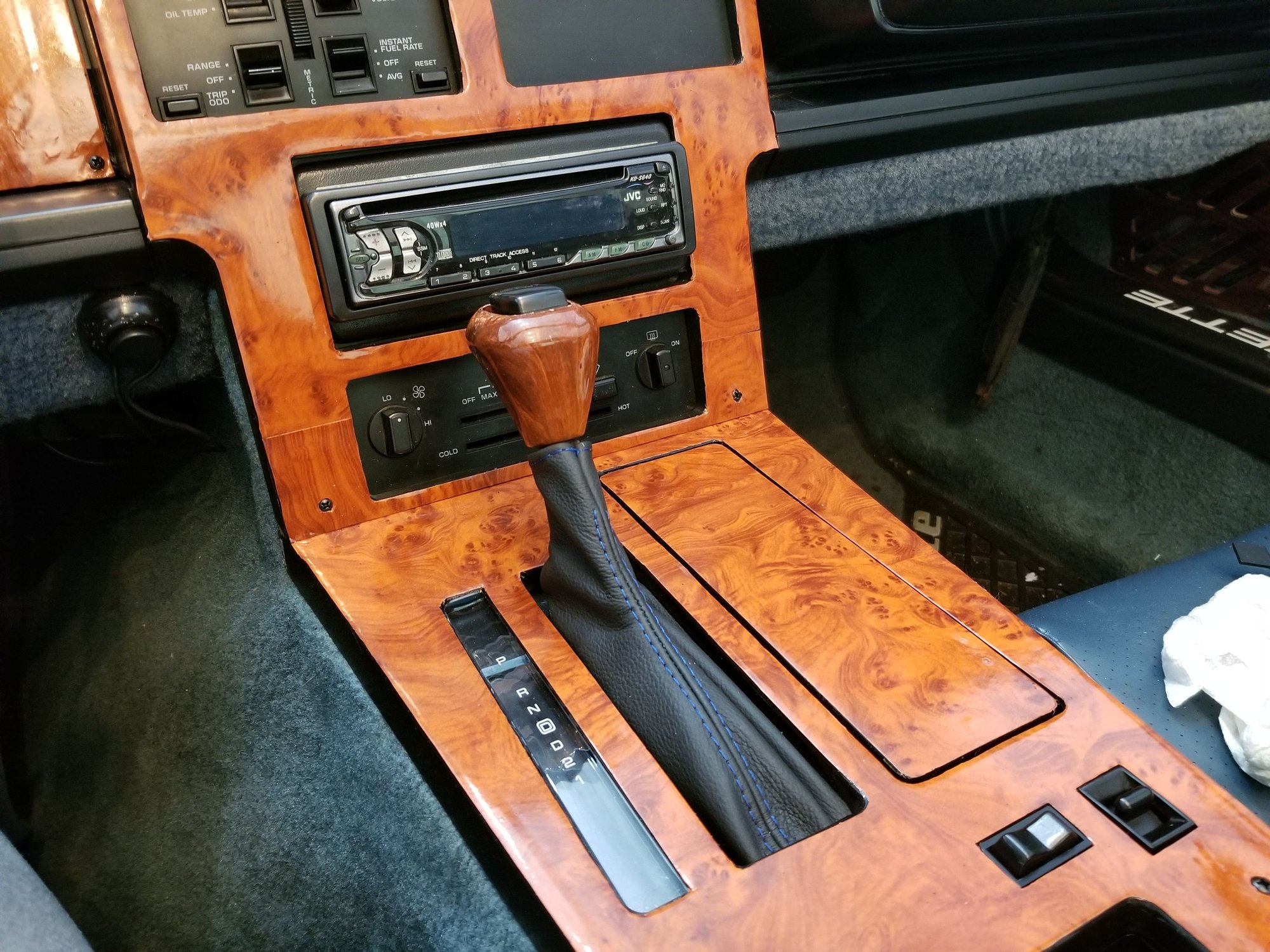

i ran into this when replacing the shift boot. They used press on steel plates and the plastic tubes broke trying to get the screws out.
I made some inserts with the printer that solved the problem
The repair is on the right

Great job, I Also had the same issue with mine, different approach though, I found
small metal tube and melted ABS plastic in it, drilled it out, heated one more time and added an insert...
