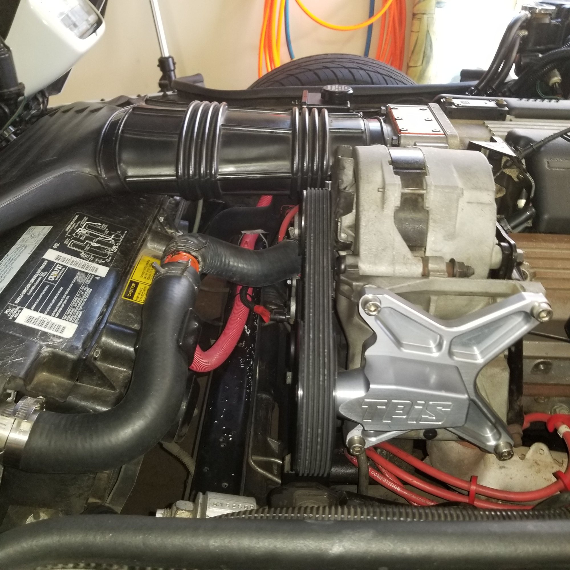

Drivers side (left)
Passenger side. (right)
I deleted the A/C on my 1992 coupe a few years back. It's also has a 160° thermostat. I live on the coast in Northern California so the summer weather doesn't get crazy hot. You can feel the power increase. Makes working on the front of the engine super easy. My only issue is when I'm in stop and go traffic. The temperature gets high and BOTH cooling fans come on at 185° and the "service engine soon" indicator light also comes on. Of course the temperature comes down. The only way to get the fans to shut down is to stop and restart the engine. The "service engine soon" indicator light also goes out. My question is. Where can I install a toggle switch to reset or turn the fans off while driving?

Got a delete pulley from Tpis and did it myself.

Negative on that. I did remove the evap and blower box, cut plates to block the openings and then used bilge blower fittings and duct from a boat to connect the two sides. I retained the heater core and can vent heat in the cabin on cold nights. I bought a bilge blower so I can blow heat but haven't installed it yet. All the parts weigh about 4lbs instead of 12 and it gave me ample room for headers and spark plug changes. My car is LS swapped and removing all the a/c stuff (condenser, lines, brackets, bolts, belt, compressor, evap box) netted me about 45lbs of weight reduction.

Why is the belt on upside down?
Old Jan 30, 2020 | 02:02 PM
Kevova's Avatar
Kevova
Posts: 6,192
Likes: 750
There was a belt with grooves on both sides.
