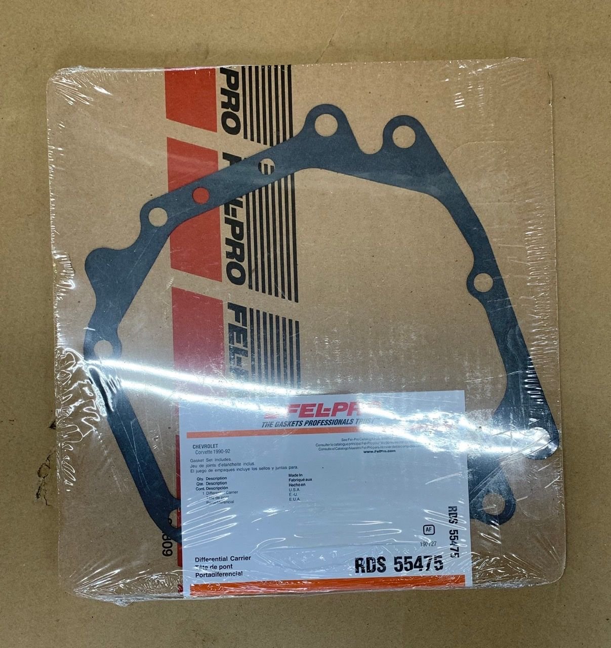

Finally getting around to fixing the cover leak. Been putting it off for more that 10 years now.

If the cover hardware is original production hardware I'd tap and use premium hardware. If hardware is original you should be able to rotate in your fingers and feel the 'tri-obal' (self threading) nature of the bolts. I've seen studs used but that could be considered maybe a stretch. I've a friend who uses a 'gasket' - and yes there is a gasket available for it!
**he'd probably do a new vent also.

Yes sir I have a gasket coming and I am making studs

I'd prefer maybe an 'over the counter' stud to my own fabrication. I'd think a reasonably easy find. 12-point head bolts more often the choice I believe.

I found some button heads that I am cutting the heads off of

Looks like she's been running a little rich. I love your lift, but those scissors-jacks make me cringe.
Nothing wrong with home-made studs, as long as they're done right. Good luck

Thank you ! yeah holley double pumpers tend to be a little on the rich side lol You might have missed it. I have jack stands just in front of the scissor jacks
