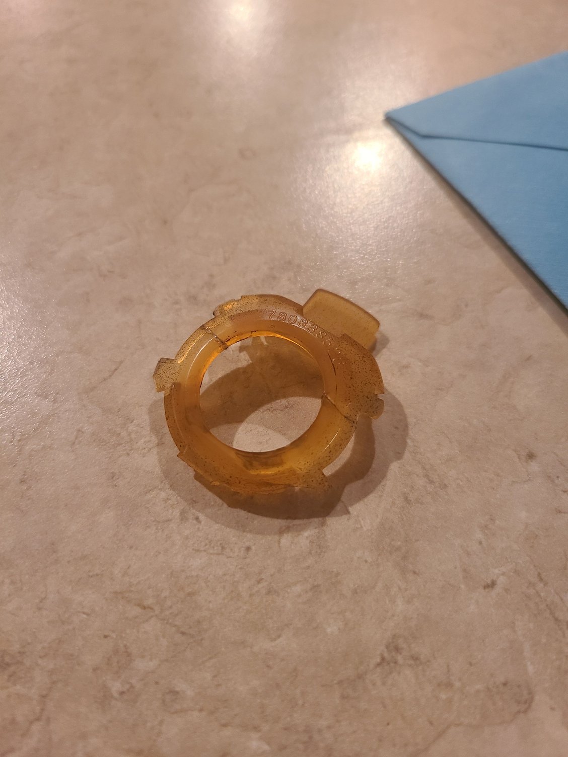

Hey guys. So I finally decided to fix the looseness in my column. Long story short, it wasn't the tilt pins causing the problem but rather the 4 bolts holding the knuckle. So that's a win. Also had parts come flying off at me because I didn't realize you need a special lock plate compressor... anyway I broke the horn clip thing that holds in the C-clip behind the contacts... I was able to push the retainer plat back in by hand and work the clip in with the help of my sister. So that was fun. Now I get to buy a nice 13$ piece of plastic before I can drive my car again.

Photo of the carnage.
Also, I am not doing oversized pins and I bent the freaking bolts for the extractor I built to pull them out lol. And really had to hammer them back in too. So I would say the housing isn't worn.

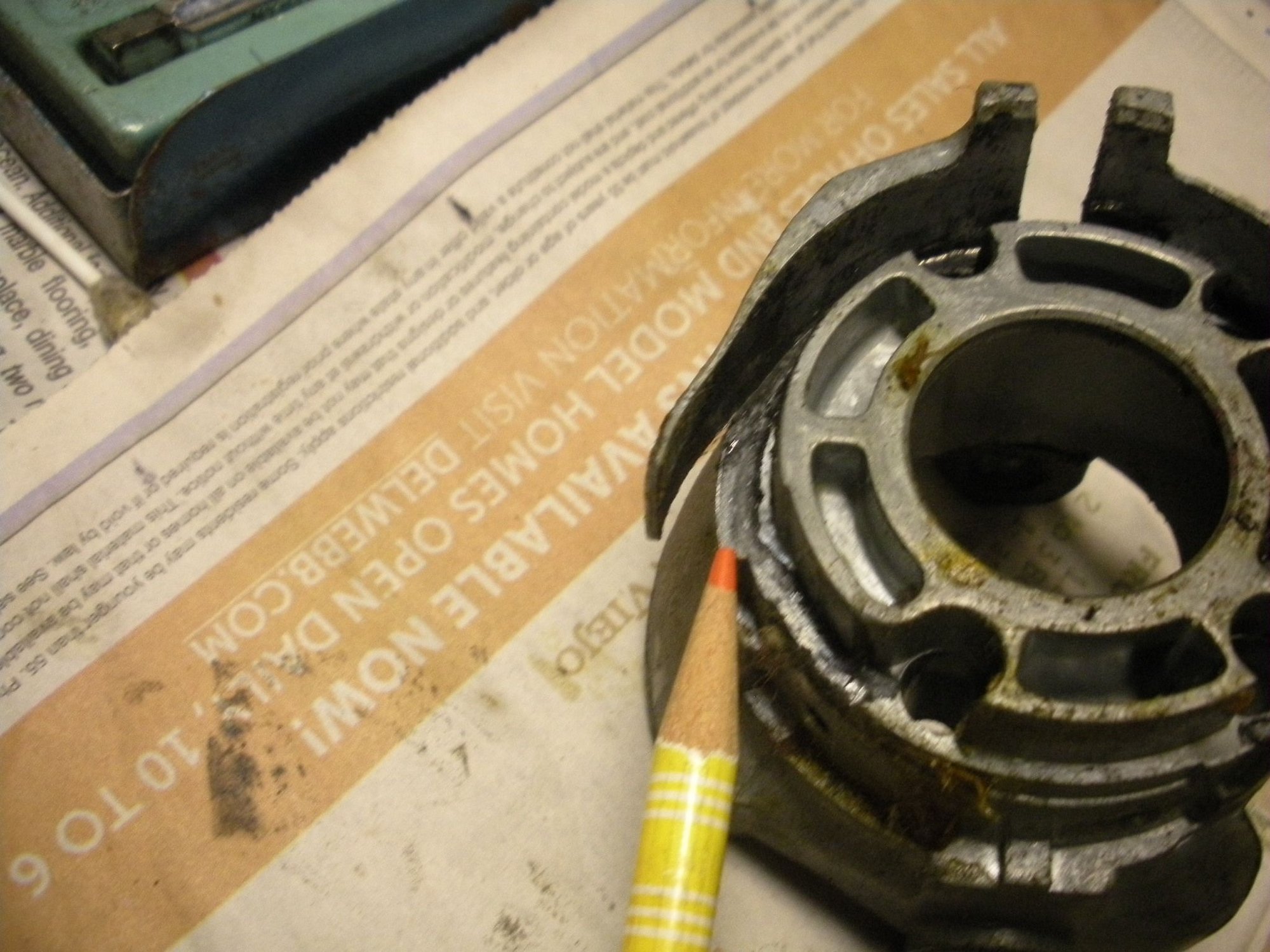

I thought the looseness in my '84 was because of those four bolts, but the real reason those bolts got loose was because the housing below that plate with the four bolts was cracked. I was able to repair the cracked housing so those bolts would have a firm surface to pull against. That plastic insulator is available from Davies Corvette.

Two of the bolts were just laying in there. I could not visually see anything wrong with the lower housing. Hopefully I didn't miss it.
