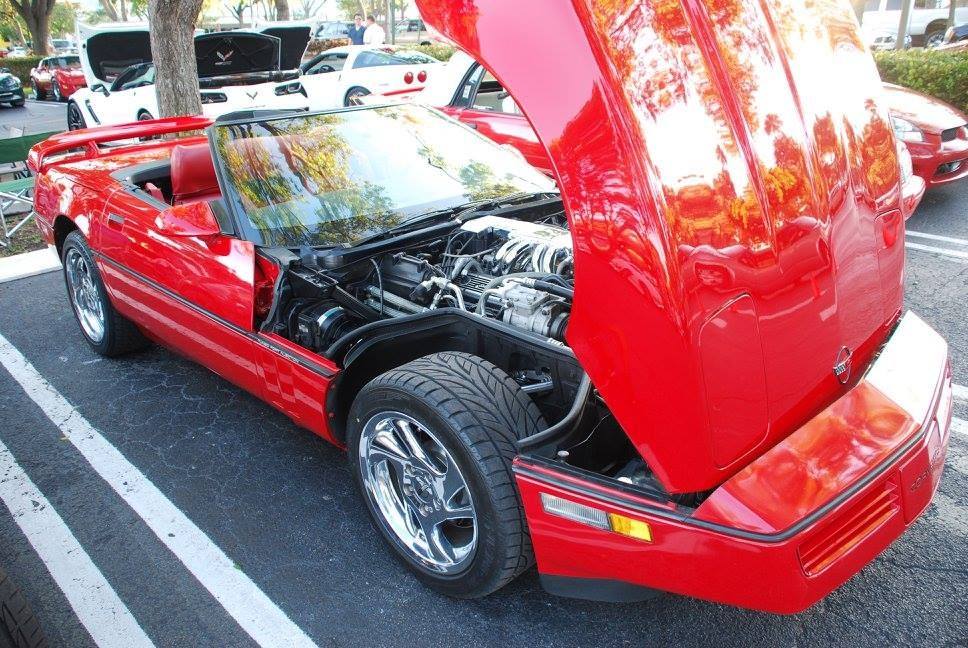

Lets post a picture, always like to see 1989 convertible, I once owned one for 24 years.
All Corvettes are red!
My old one.

here's mine
