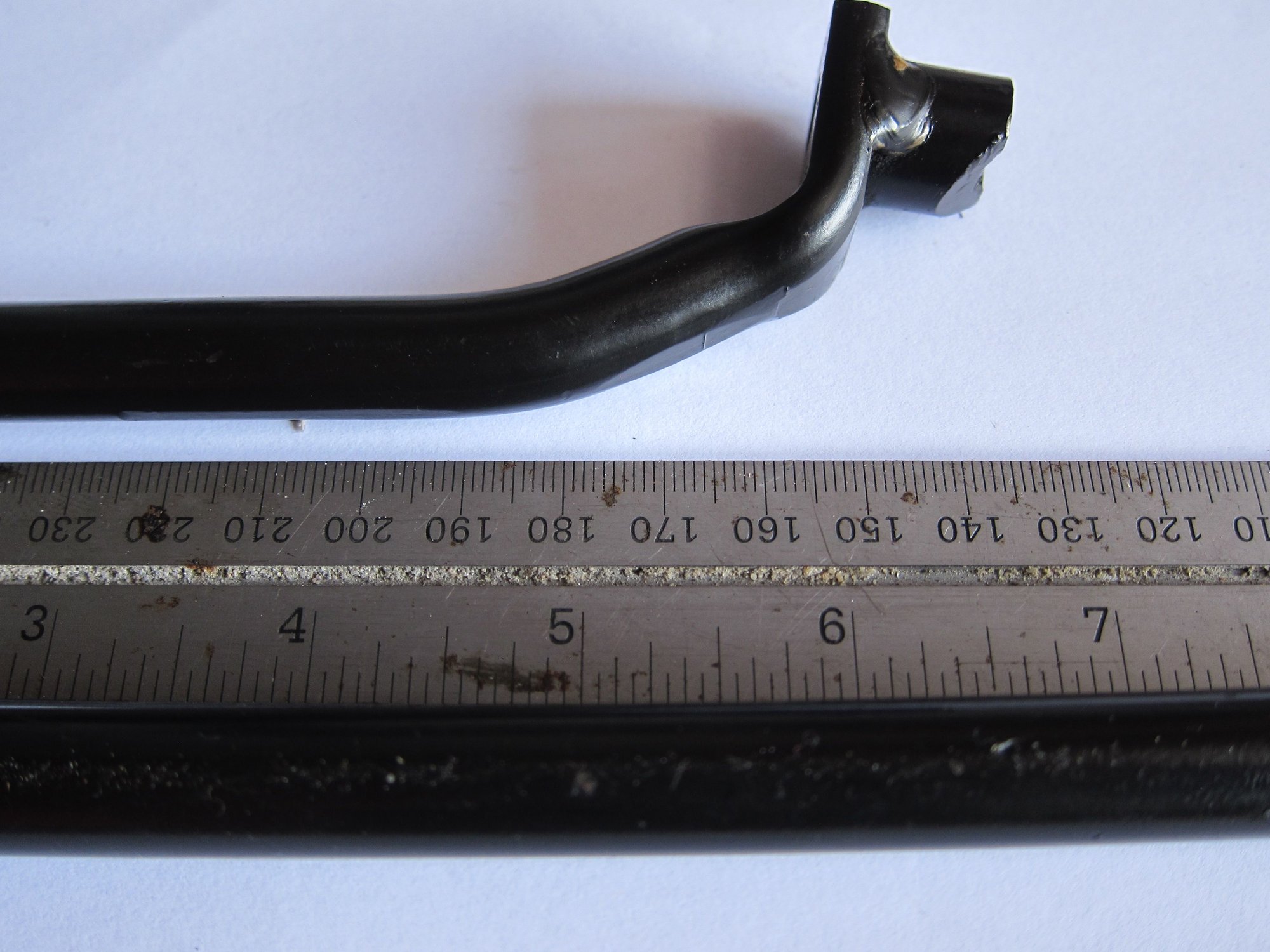

Is anyone able to identify the attached 2 engine brackets. They are off a 1990 C4 L98 engine and most likely from the passenger side. They are surplus after an engine rebuild and we cannot locate where they fit back onto the engine and what they support...Many thanks!

A/C compressor support brackets.
Without them, you run the risk of the large aluminum bracket cracking.
That's were they go to support of the compressor.

Aren't there 3 brackets on a 90?

Can't tell if it is #6 or #9
I think maybe it's #5 and #9. i agree can't tell - 6 or 9 - ???

Originally Posted by Joe C
I think the OP's pic is #5 and #9....
I meant the missing bracket. You think he has #9 and therefore missing #6? If so, I'd get all 3 installed or it could be bad. Ask me how I know.
I agree, install all three. no matter what he has showing, and what's missing, It will only go together one way. it's been about 6 or 7 years since I worked on my 90 - memory's not what it used to be....
Can we ask how you know this? My case was 2 broken brackets.

Hi Guys,
My special thanks for all your help and inputs. Your contribution made it easy to locate. We found their homes and no parts left over which is a good sign after a full engine rebuild.
Now we just need to set the timing, re-gas the A/C and a few other minor jobs and take it for a run. It all looks good so far. No parts left over which is a good sign...Can't wait until it's all complete and on the road.
