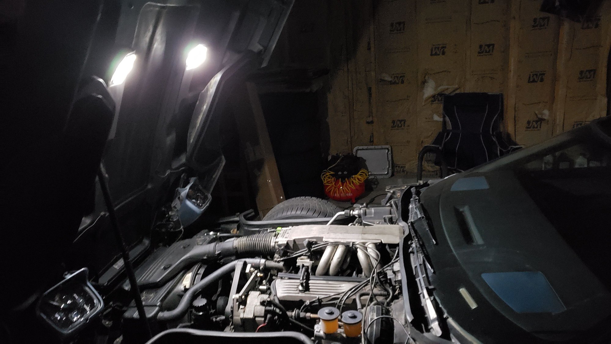

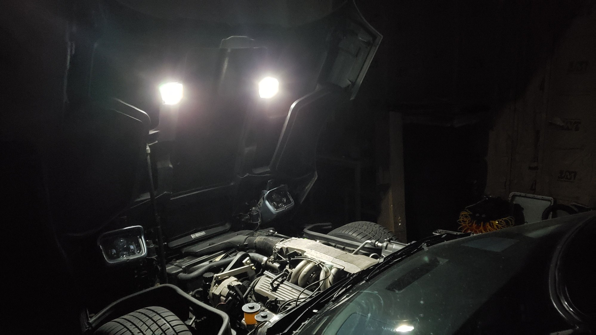

Since one of my 1996 C4 CE underhood light bulbs was missing and the other was not the original GM bulb anyways so I decided to replace them both with LED equivalents.
The OEM bulb is 12.8v and 10 watts and 1.72” long. While I was social distancing in line at my local auto parts store I noticed that the Sylvania Zevo LED bulb designed to replace a standard 578 bulb matched those specs (obviously the LED bulb pulls considerably less power at 1 watt).
Grabbed two for $18 total adding to the EP moly grease and Bleech-White Tire Cleaner I already had in hand.
Installation took all of 10 mins for both and that would have been half that if I didn’t keep dropping the mounting screws into the dark recesses of the engine compartment.
Comparable brightness to the old filament bulb and a color temp around 4500k if I had to guess (no annoying blue tint).

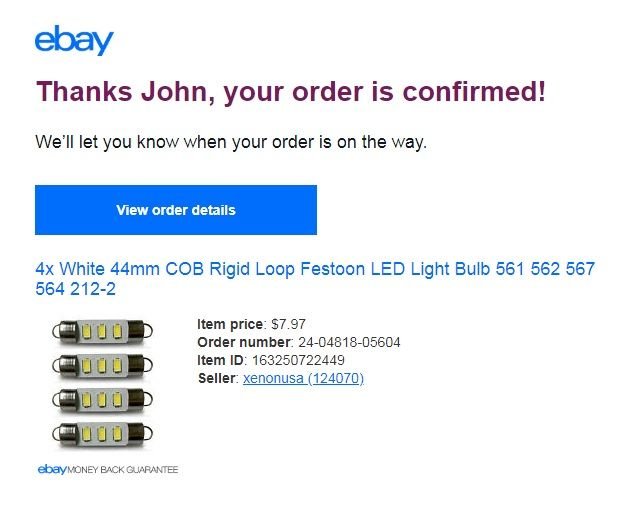

I found these and no charge for shipping !!!
these were for the interior lights (4)
