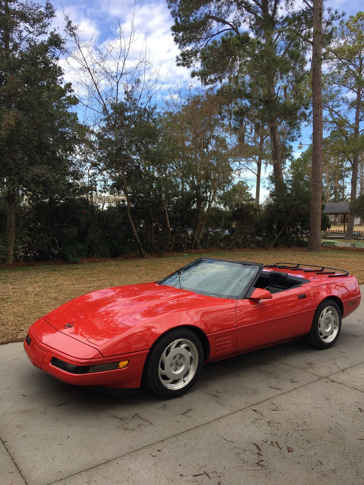

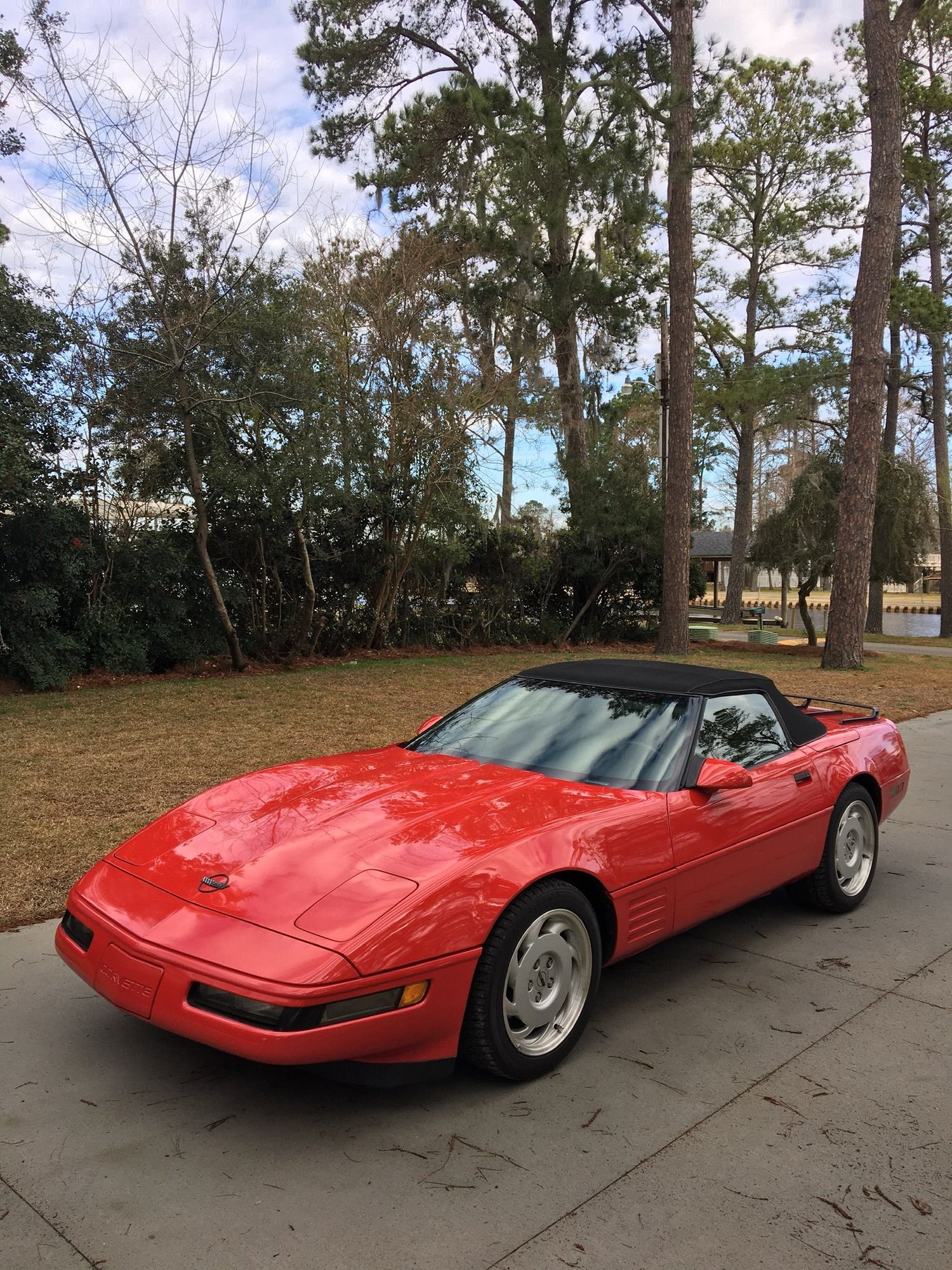

I have a 1991 convertible how do I find out what type of L model it is? The car is all stock, how do I find out hp, gear ratio, torque.
i have the Marrone label from the dealer. I got lucky when I found this vette
