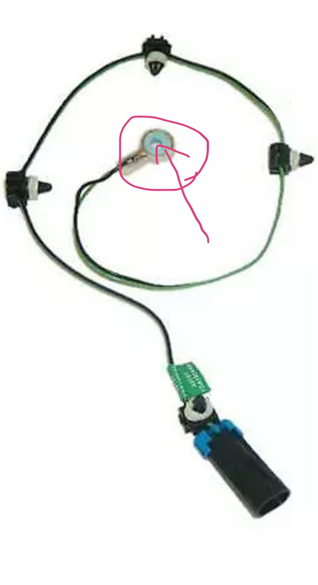

I will also add when I was changing the original door lock cylinders I removed them which included disconnecting the door lock switch wiring harness that fits to the back of the cylinder. I included a picture and also drew an arrow to the center part that slides over the end of the lock cylinder. See picture...
The arrows points to the middle of the harness connector that slides over the door lock cylinder. When I removed the originals a plastic piece came off that was circular like a collar and slid over the lock cylinder end between the highlighted part of the harness. I don't have either piece because when I removed them they were so old and brittle they both disintegrated in my hand!
I am wondering if that was some type of insulator or mechanism that prevents connection between the lock cylinder with the key in it making electrical contact to the harness only when in a certain position? This is about the only thing I can think of since no other trouble shooting is working! I am tired of taking the door panels on and off. I want the car to work as if it came from the factory so disconnecting the interior/courtesy lights by pulling a fuse isn't an option for me. I want to fix all problems now to preserve the car for long term. If anyone can help with info please do. It's a 93' convertible. Door pins have been replaced and adjusted and are working fine. The CCM shows no faults, and I replaced the chime module too, along with checking the PKE module and making sure all connections to the CCM were good based off of sight only when I had the entire dash off. I also just got my PKE working again just fine even though it takes a minute sometimes for it to wake up. I changed the battery in the key fob. As of now, I can't think of anything else. I was suspecting the relay module(I think that is what it is called) under the passenger dash, but since it's hard to access and the test shows it's working fine. I want to figure out these door lock switches and the harness inside the door... I am going to disconnect both door lock switch wiring harnesses to see if I can get the code for Module 1.3 input ID 03 Door key switch alarm info to show 0 = (I'm assuming it should show disabled). Any help or advice would be greatly appreciated!
