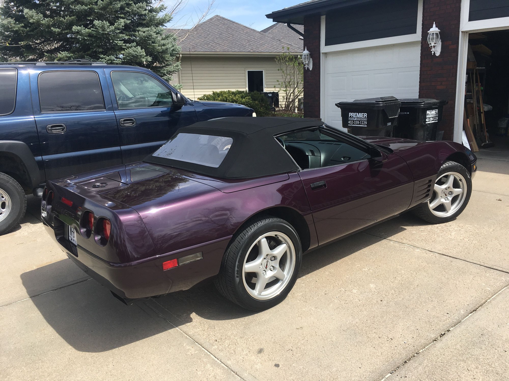

I just had 1 installed by Lions Upholstery in Omaha. I bought a Robbins Brand top online from convertibletop.com. Lions are a Robbins dealer but said that I could get it online and save some money. I got a black Hartz stayfast canvas top. The piping on the seams is made of the same top material and looks better than the shiny piping that the cheaper ones use. I got 1 with a clear vinyl window. Looks great and I would recommend it. I don’t know about hooking up the defroster part. Be well. Kevin
This was right after it was installed.

Man that's a pretty car. The color and the wheels.... just... NICE.

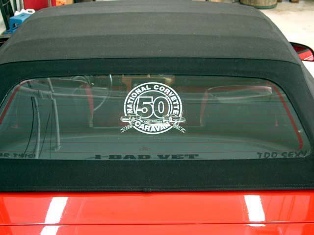

When I owned a C4, I had my top replaced with conversion kit on my 89, bought from Al Knocks makes the best when it comes to all years of Corvette's.
If you can find the conversion kit, make sure the tech doing the work, knows what there doing, other wise you can crack the gass, with no replacement glass.
I also has someone mentioned you loose storage room, and be careful when back out for trip, always soft items. Never force the lid closed, you can crack the glass.
I replaced all my seals on the top, 3M Adhesive removal was the best to get that glue out of it's tracks, and make sure you get all the glue, otherwise the new seals won't seat properly. You might want to also buy 3M rubber glue, but don't use it unless you really have to when the seals curve on the tracks.
Anyone that ever replaced there seals, they will tell you it looks easy, and quick, it's not, patients and don't rush, it look lousy and water leaks.
I replaced all the seals, used very little glue, and it took me 10 hours without a break for lunch.
Good luck. have fun!
