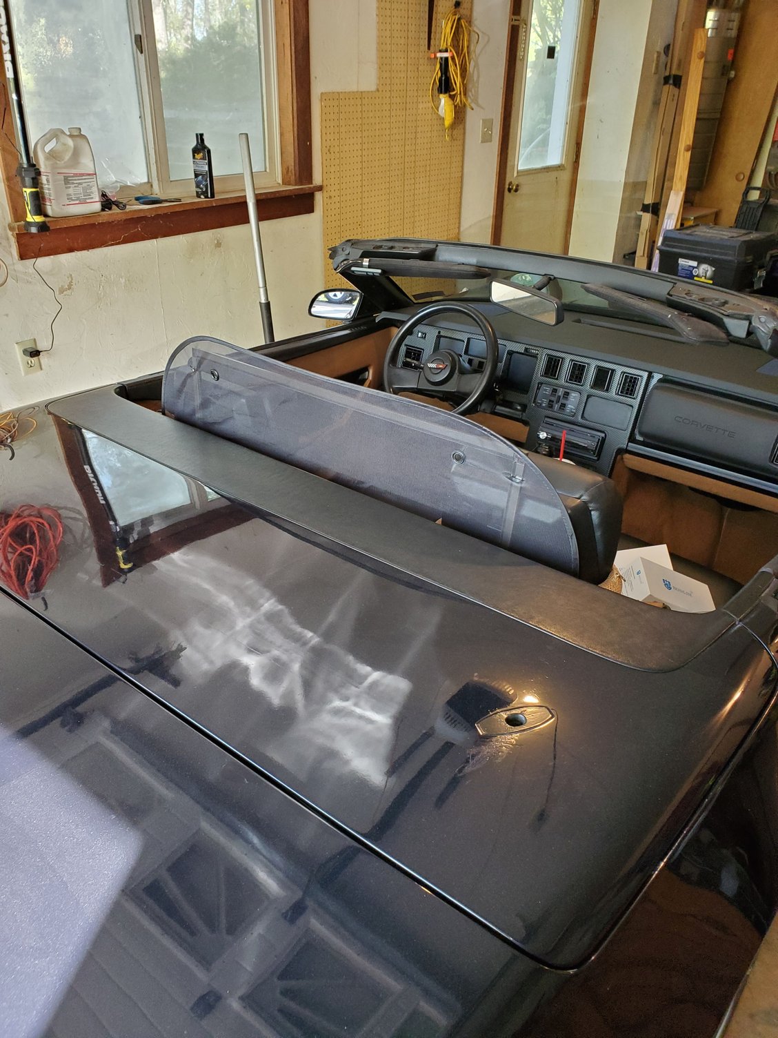

I posted in the what did you do thread today but thought I would repeat it here as I am looking for some feedback and probably should not clog up that thread with responses. I wanted a rear wind deflector for my 89 vert. While there are not many to choose from for the C4 and the one I really want is the lighted plexi one with the C4 emblem etched in it, I cant spend the 400 right now. So... I looked around and decided to fabricate my own. Let me know if you think it looks ok or if it is obviously cobbled together. It is my first attempt and I will try for different or better materials if I like it. It does work very well. Let me know what you think?

Looks fine. Looks as good as the other cars that have that from the factory.

Maybe cover it in some cloth material so it's not so transparent. Unless that's the look you're going for.

Looks good to me? Should do the job. Dont mess up that bald spot

I think it looks good ...

Thanks for the responses. I am using a screen mesh so that I can still see out the rear view mirror. If I cover it with cloth I lose that. And I am lucky..... I have all my hair!

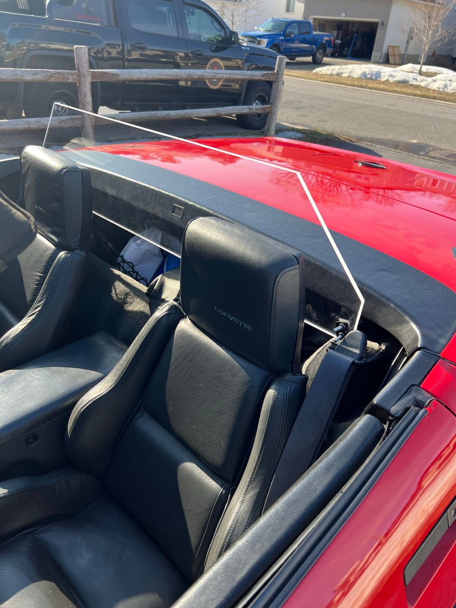

I know this thread is 3 years old.... but...
Do you find it makes a difference? I'm in the same boat (want one but can't justify spending $600ish CDN for one.
I mocked one up with cardboard (based on pictures of the wind deflector product) and tested opening and closing the roof.
I'll need to weld up some brackets and finally re-purpose a thick plexiglass covid screen that was in the office.
Before I start cutting the plexiglass and break out the welder it would be nice to know if it actually helps lol.

So I built one and tested it out yesterday. I would say it reduced the wind by 50% at very least.
My net costs was a $20 sawblade from Amazon to cut up a repurposed covid shield. I welded up the brackets out of 2 old shelf brackets and I used foam pipe insulation spray glued to the brackets to provide a cushion tightening up the screws that held the bracket to the plexi.
$20 is better than $770
