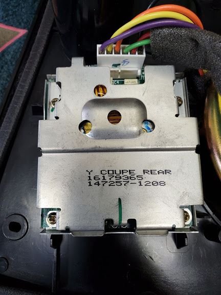

Hey Guys,
My wife and I just bought a 94 coupe(our first C4). It;s a great car but I would like to make it better by fixing a few little things that can be expected in a 26 year old car.
For starters we noticed that the rear passenger speaker isn't working. I took the speaker out, found it disconnected so I connected it but all it puts out is high pitched hum. I tried a different speaker that I had on the shelf and still just a hum. I then swapped the speaker/amp unit side to side and the problem followed so I think I'm in need of a rear amp. The one pictured is the one I believe has failed.
My question is does anyone repair these amps and if not where would a guy look to find one as I've looked with no luck. Another question is, does any other GM vehicles of the era use these amp, possibly with a different part number but still able to function in the Corvette?
Thanks.

https://www.doctordons.com/corvetteradios.htm is a forum favorite for these types of repairs. I'd give him a call and see what he says.

BoseCentral.com repairs them for $50 and does a good job with quick turn around.

Two great options, Thanks guys!
