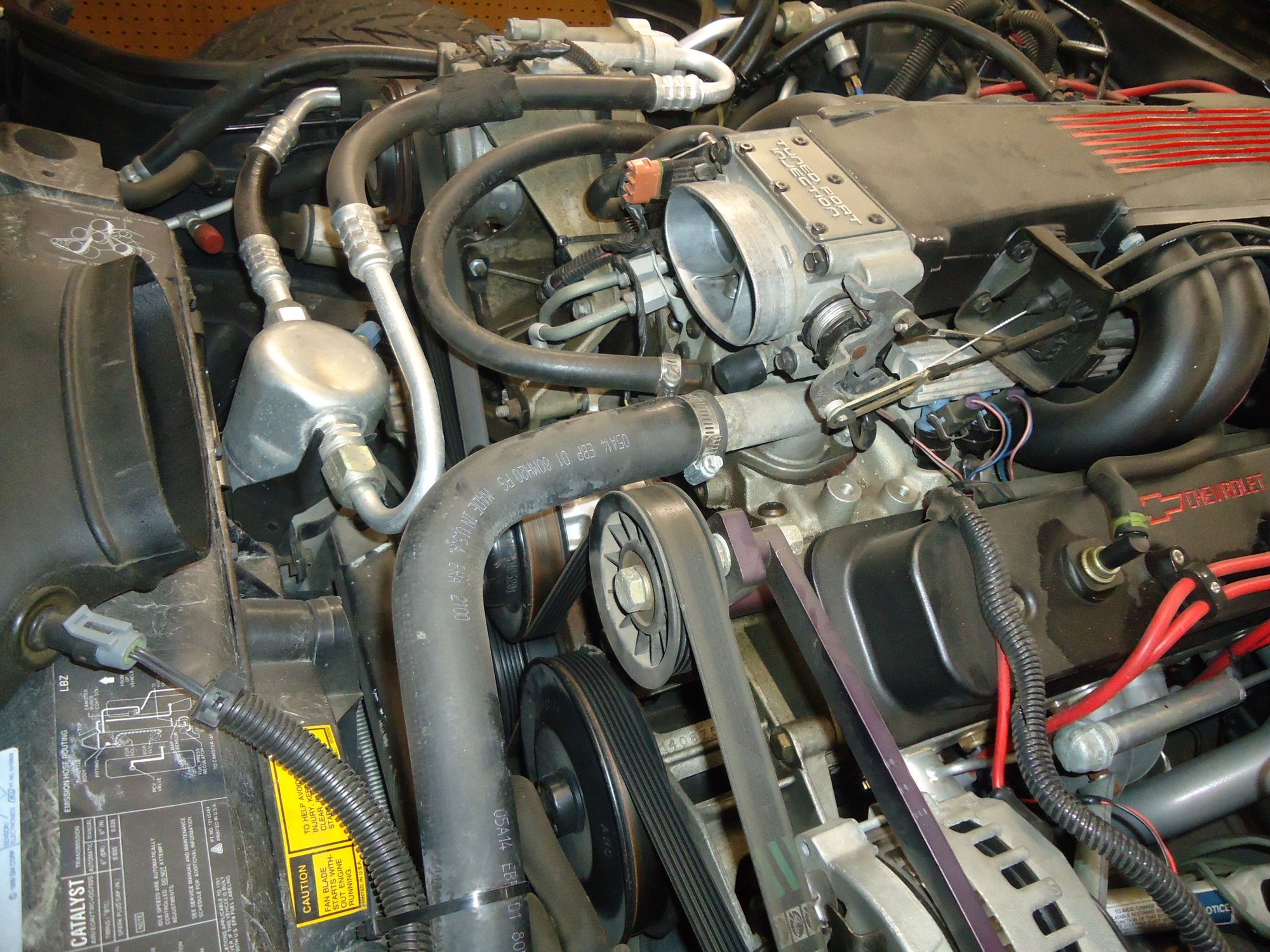

Not sure if this helps?

Thanks TA, but I need a close up of the throttle cable connector as it attaches to the throttle plate. All we have is the cable, but don't know how it attaches and it seems no one sells a new cable so we need to improvise.

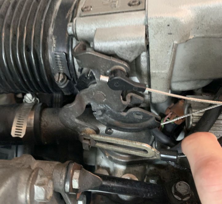

From top to bottom: TV cable, throttle cable, cruise control cable.

Thanks jv999, that is what I needed, but what keeps the cable attached to the half moon shaped piece?
At the left side of the half moon there is a slot. The cable has a small T at the end that fits in that slot. You can see a bit of it poking out.

OK, now that you pointed it out I can see it. Thanks again
