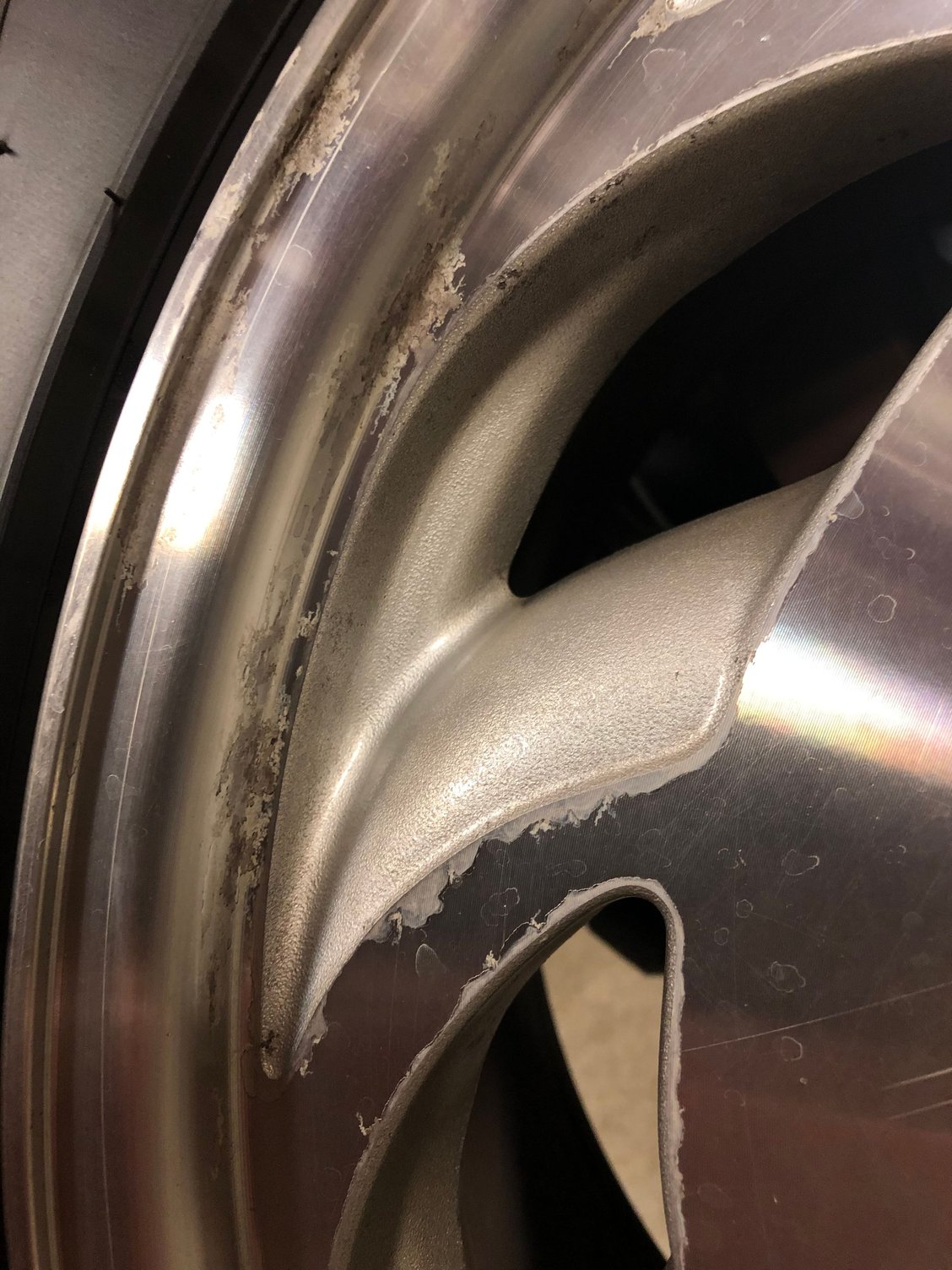

OP - Is the snapshot one of yours OR just an image you 'borrowed'? If yours, is it the worst or best? The polished flange isn't an issue to get machined and restored. The wheel face is a different issue and depends very much on actual condition. You definitely only want to deal with a 'local' vendor.

Thanks for the responses. That is one of my wheels. They are all somewhat the same. I was quoted $185 per wheel to restore them to "new".

If you have issues with the 'machined face' the DIY likely won't make you happy. If it's only the clear finish or scuffs from a 'tire boy' on the rim edge a DIY will do for you.

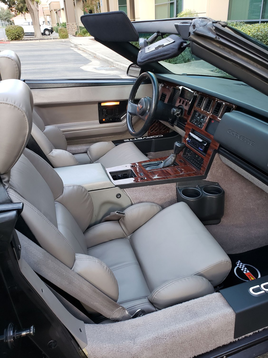

Thanks guys I appreciate the help and the advice. As for the question it is an automatic, unfortunately. After I bought it I completely redid the entire interior, seats carpeting sound deadening and a new audio. Love the climate control

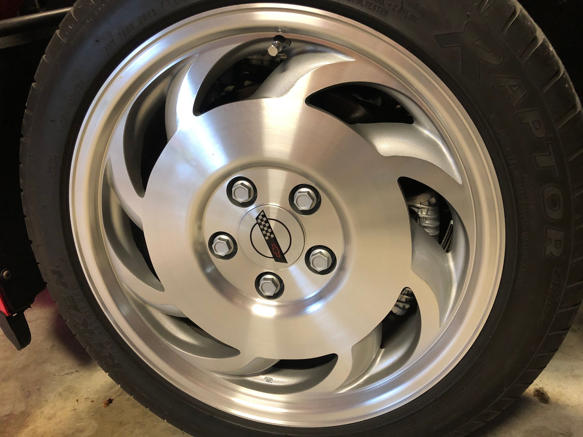

Here in Huntsville, AL, it was $125 per to recondition mine a few months ago.
Perhaps keep shopping around?
I also cleaned/sprayed the lug nut covers and painted the calipers while the rims were out being worked.
Before...
Before...
After...

They did a great job on your wheels. Thanks for the reply.

They did a real good job. Only problem I have/see with refinishing the 88-90 wheels, they are actually a welded two piece. So you have that gap going around which definitely makes it tough to clear and protect the finish.
